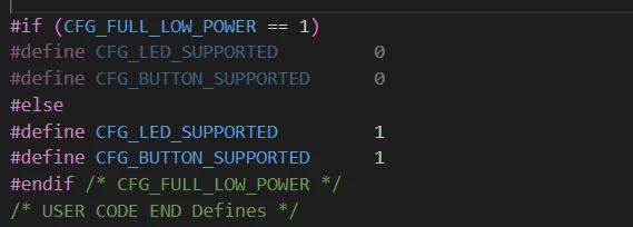

How to put Matter Device into Sleep Mode
We are developing a Matter device using X-CUBE-MATTER.
When we set CFG_FULL_LOW_POWER to 1 to enable sleep mode, pressing B1 for 10 seconds does not enter Factory Reset and BLE advertising is not executed.
When we checked the current consumption, it seems to be in sleep mode, but because BLE advertising is not executed, commissioning is not possible.
Please tell me the solution or the specification.

in app_conf.h where you are setting CFG_FULL_LOW_POWER 1, there is also this code below.
2024-10-09 09_22_57-app_conf.h - STM32CubeExpansion_MATTER_V1.1.0 - Visual Studio Code.png
Which means that buttons are not used at all. You can simply change this define to enable them.

EPASZ.1
Oct 11, 2024 6:36 AM UTC
As I said above you can change the above defines so that the buttons are active with low power. Then after rebuilding, you can use button1 to do factory reset and advertise.
With the default settings, factory reset cannot be done in low power mode.

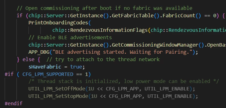

EPASZ.1
Nov 6, 2024 8:11 AM UTC
It is possible that in low power modes, the device is not communication fast enough with the OTBR to do the commissioning.
In such case, you can disable the LP modes by commenting out the UTIL_LPM command in app_entry and then enable them again inside AppTask::Init() (if the device is already commissioned on boot)EPASZ1_0-1730880532395.png
+ inside AppTask::MatterEventHandler (when the commissioning is finished)
You could go a step further by enabling it at the start and disabling it on BLE connection (that's the start of commissioning) but that's up to you.

EPASZ.1
Nov 6, 2024 9:12 AM UTC
Most is covered by what I wrote in my previous post. To enable LP modes after BLE advertising is over, you need to copy/replace the 3 attached files and then register some callbacks in AppTask::Init()
APP_MATTER_BLE_Set_Advertising_Callback((BLEFastAdvertisingCallback) BleAdvFastHandle, (BLESlowAdvertisingCallback) BleAdvSlowHandle, (BLEStopAdvertisingCallback) BleAdvStopHandle);
Define BleAdvStopHandle callback so that it enable the LP mode like above.
No, ICD cluster only lets the controller know that the device uses LP modes. This is defined inside CHIPProjectConfig.h. Default values are used, but it generally works well because Run/LP modes are managed by FreeRTOS.

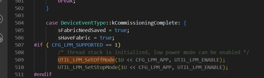

Is it necessary to comment out (not enable) UTIL_LPM_SetStopMode(1 << CFG_LPM_APP_THREAD, UTIL_LPM_ENABLE); in app_thread.c (not enable here) and add (enable) UTIL_LPM_SetStopMode(1 << CFG_LPM_APP_THREAD, UTIL_LPM_ENABLE); in AppTask .cpp, is it necessary to add (enable) UTIL_LPM_SetStopMode(1 << CFG_LPM_APP_THREAD, UTIL_LPM_ENABLE); when kCommissioningComplete is executed?
EPASZ.1
Nov 6, 2024 12:52 PM UTC
In app_thread.c, you shouldn't modify anything. This handles the LP modes for the stack point of view.
In AppTask, yes you need to enable it under kCommissioningComplete - it is part of my previous post.
AkihiroNAuthor
Senior
Nov 7, 2024 1:25 AM UTC
Thank you for your help.
I have implemented the changes you shared.
I tried commissioning on the Apple platform, but it failed. It seems that the network is participating (up to kCommissioningComplete), but if you put CFG_LPM_APP in stop mode or sleep mode when setting the HomeApp side afterwards, the connection will fail.
As a test, you can comment out UTIL_LPM_SetOffMode(1U << CFG_LPM_APP, UTIL_LPM_ENABLE) and UTIL_LPM_SetStopMode(1U << CFG_LPM_APP, UTIL_LPM_ENABLE) in case DeviceEventType::kCommissioningComplete: to successfully complete the commissioning process.
You may also need to enable Sleep Mode or Stop Mode at a later time. Please tell me how to do this.
