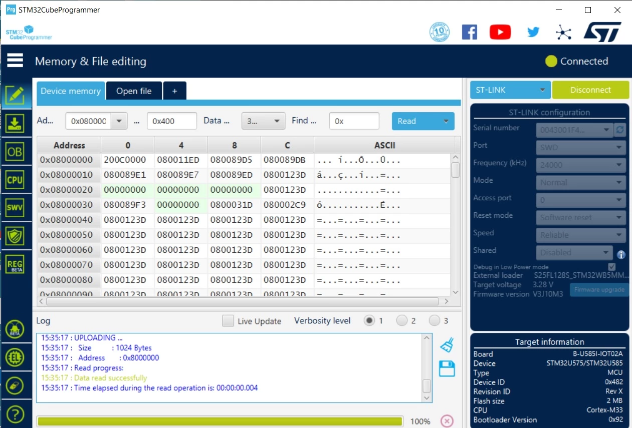

IVent.1
IVent.1Author
Senior
Dec 13, 2022 2:57 PM UTC
Hi Romain,
I'm in this situation...the connection with the STM32cubeprogrammer is established, but in this way I have access only to the stm32u5...how to access to the stm32wb?0693W00000WKufNQAT.jpg

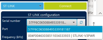

In your case, you have 2 STLink:
  • One onboard on CN8 USB for U585 device.
  • A second external connected on CN5 for STM32WB5MMG module.
If it's correct, you should inform STM32CubeProgrammer which debugger you want to use:
In disconnect mode, refresh Serial Number and chose the correct STLink Serial Number to use.
An example below:
Best regards,

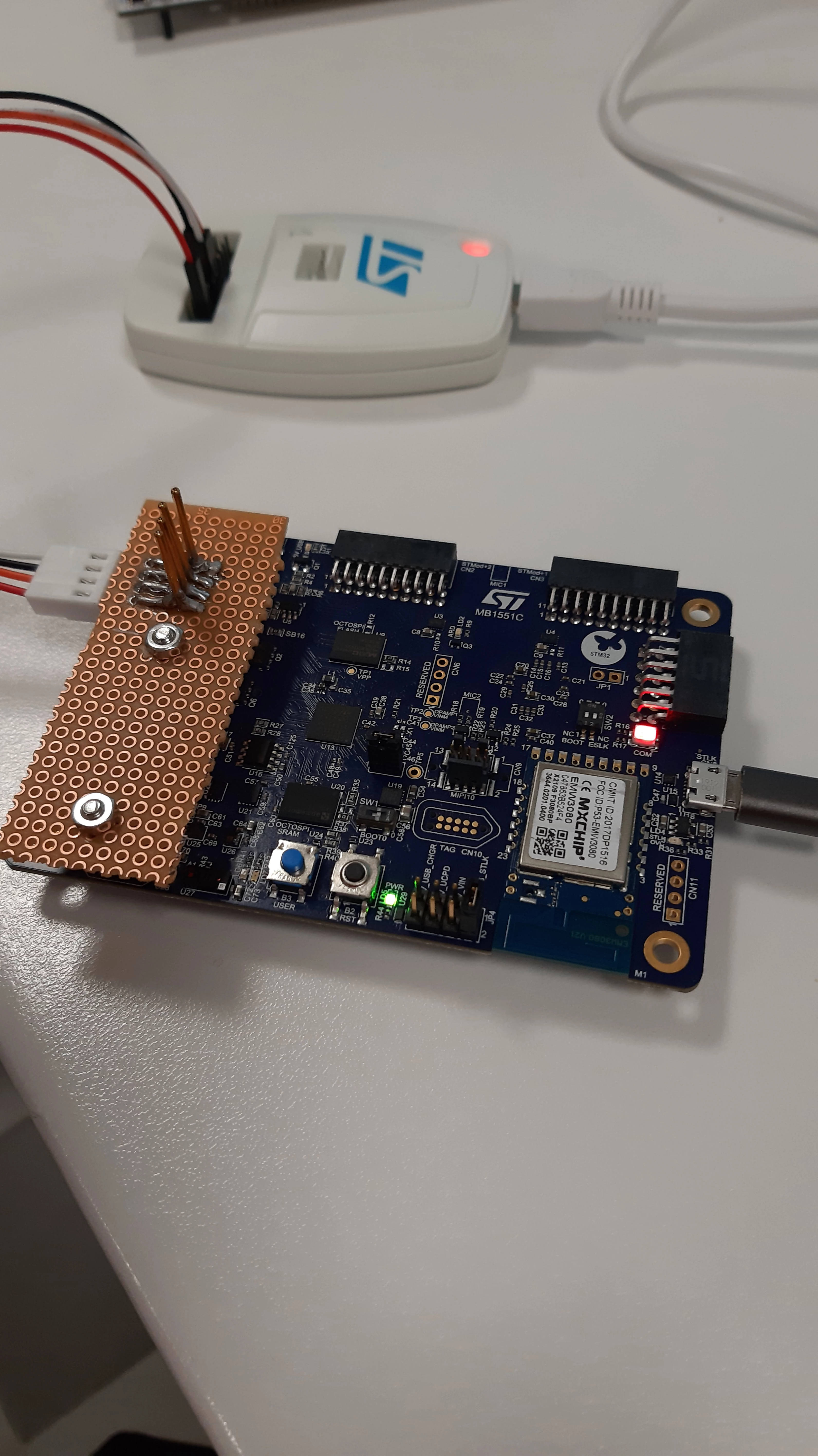

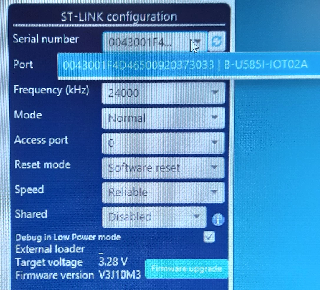

IVent.1
IVent.1Author
Senior
Dec 13, 2022 4:13 PM UTC
Hi Romain,
I have a second external stlink connected to the CN5 (the Device Management of the pc shows both the 2, ST-Link Debug and STM32 STLINK), but STM32CubeProgrammer shows me only the ones of the main board. 0693W00000WKv8FQAT.jpg0693W00000WKv93QAD.jpg
RomainR.
Dec 13, 2022 4:33 PM UTC
Hi IVent.1
If after refresh icon 0693W00000WKvDeQAL.pngYou detect only onboard STLink on U585, you have to check hardware connection between your computer and the external STlinkv2 plugged on CN5.
Confirm if the USB cable is a data version (and not a only charger version) otherwise change STLinkV2, change USB port.
If you are using Windows OS, you can check in Device Manager if STLinkV2 appears in USB Device list.
When your operating system will detect both STLinkV3 onboard and STLINKV2 external then STM32CubeProgrammer will list them.
