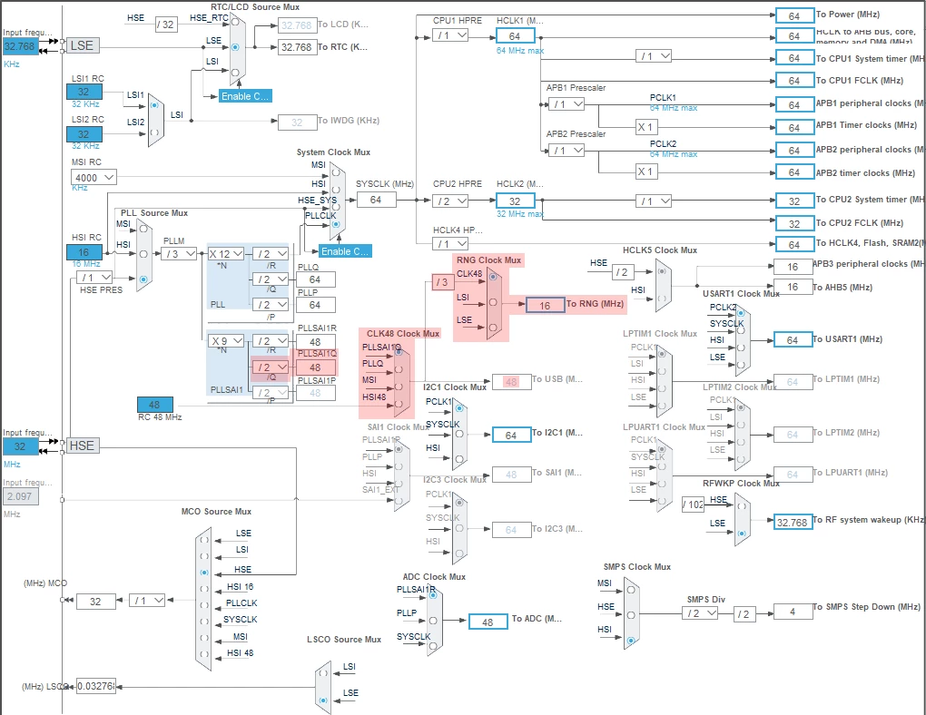

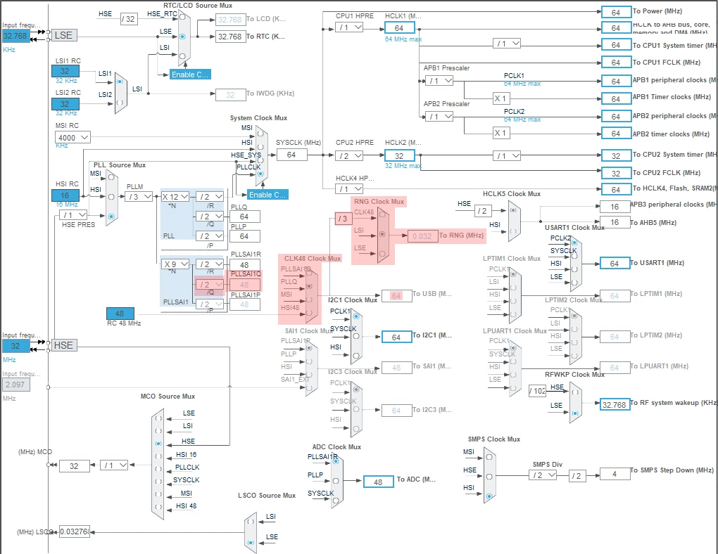

Unfortunately, neither A nor B were developed by me, and B didn't even use CubeMX and therefore it has no clock configuration diagram to look at and compare. A does use CubeMX, but A and C have identical clock configuration diagrams, apart from the RNG bit which C uses but A doesn't (marked red). That's also why I assumed C's clock configuration would be correct, but apparently it isn't.
Clock map A:
Clock map C:

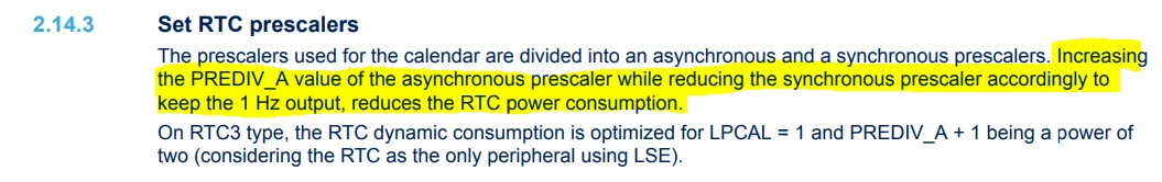

For the power consumption, accordingly to the AN4759 (Using the hardware real-time clock (RTC) and the tamper management unit (TAMP) with STM32 microcontrollers - Application note) :
STM32WB serie have a RTC2.
Have a good day.

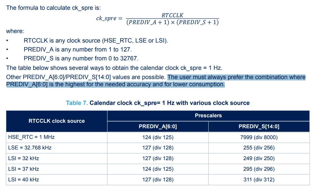

Yes, that's what I found, but also section 2.1.4 says:
But how do I chose PREDIV_A? I understand that (PREDIV_A + 1) * (PREDIV_S + 1) must equal RTCCLK. That's why 127/255 of A works, and 15/2047 of C does as well, but obviously not 15/32767 of B.
But what condition does PREDIV_A need to meet in order to have an RTC accuracy of 1ms, 10ms, 500ms, etc.? How do I calculate PREDIV_A from the needed accuracy?
Dec 6, 2023 1:05 PM UTC

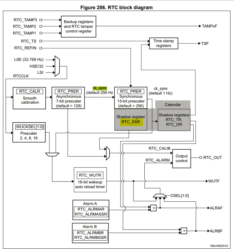

The RTC accuracy depends on your input clock and his own precision. The RTC allow you to do a smooth calibration, if needed. (ref section 29.4.11 "RTC smooth digital calibration" of rm0434).
To obtain the 1 Hz input to the calendar, you can use PREDIV_A = 127 and PREDIV_S = 255. Alternatively, you can use PREDIV_A = 15 and PREDIV_S = 2047, but this will impact consumption and RTC_SSR.
The sub second register (SSR) is updated using clk_apre = 32768 / (PREDIV_A+1).
With PREDIV_A = 127 you add 1 to the sub second register each 3.9 ms.
With PREDIV_A = 15 you add 1 to the sub second register each 0.5 ms. This allows a better SSR precision.
(And with PREDIV_A = 31 you add 1 to the sub second register each 0.97 ms. Which is the config the closer to the ms).
The RTC_SSR is used to configure alarm with the millisecond precision.
