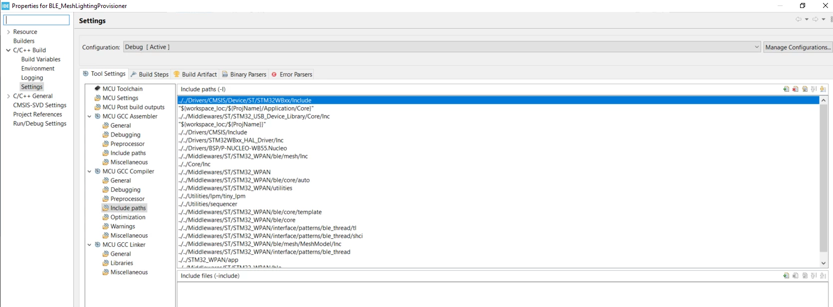

How to initialize STM32WB Interrupt manually without using CUBEMX ?
Hello ST,
I am using BLE_MeshLightingProvisioner Project, PB 12 and PB 14 used for external interrupt purpose.
Please find the following modification
=============main.c================
 /* GPIO Ports Clock Enable */
   // __HAL_RCC_GPIOC_CLK_ENABLE();
  __HAL_RCC_GPIOB_CLK_ENABLE();
 // __HAL_RCC_GPIOA_CLK_ENABLE();
 /*Configure GPIO pins : Key_Pin Door_Pin */
 GPIO_InitStruct.Pin = Key_Pin|Door_Pin;
 GPIO_InitStruct.Mode = GPIO_MODE_IT_RISING_FALLING;
 GPIO_InitStruct.Pull = GPIO_PULLUP;//GPIO_NOPULL;
 HAL_GPIO_Init(GPIOB, &GPIO_InitStruct);
 /* EXTI interrupt init*/
 HAL_NVIC_SetPriority(EXTI15_10_IRQn, 0x0F, 0);
 HAL_NVIC_EnableIRQ(EXTI15_10_IRQn);

=======================build setting ==========================
=======================app_entry.c=========================

/*------------------------------------Issue------------------------------------------------*/
It is responding to below read condition:
if(HAL_GPIO_ReadPin(Door_Port,Door_Pin)== GPIO_PIN_RESET)  {}else{}
but Callback function not responding to associated external interrupt..
Let me know if i missed anything to initialize the GPIO pin interrupt...

Remy ISSALYS
Mar 11, 2022 2:19 PM UTC
Initialization and configuration of GPIO and external interrupt seems to be good. GPIO_MODE_IT_RISING_FALLING corresponds to external interrupt mode with rising/falling edge trigger detection, so callback function will be call only when pin state changes.
