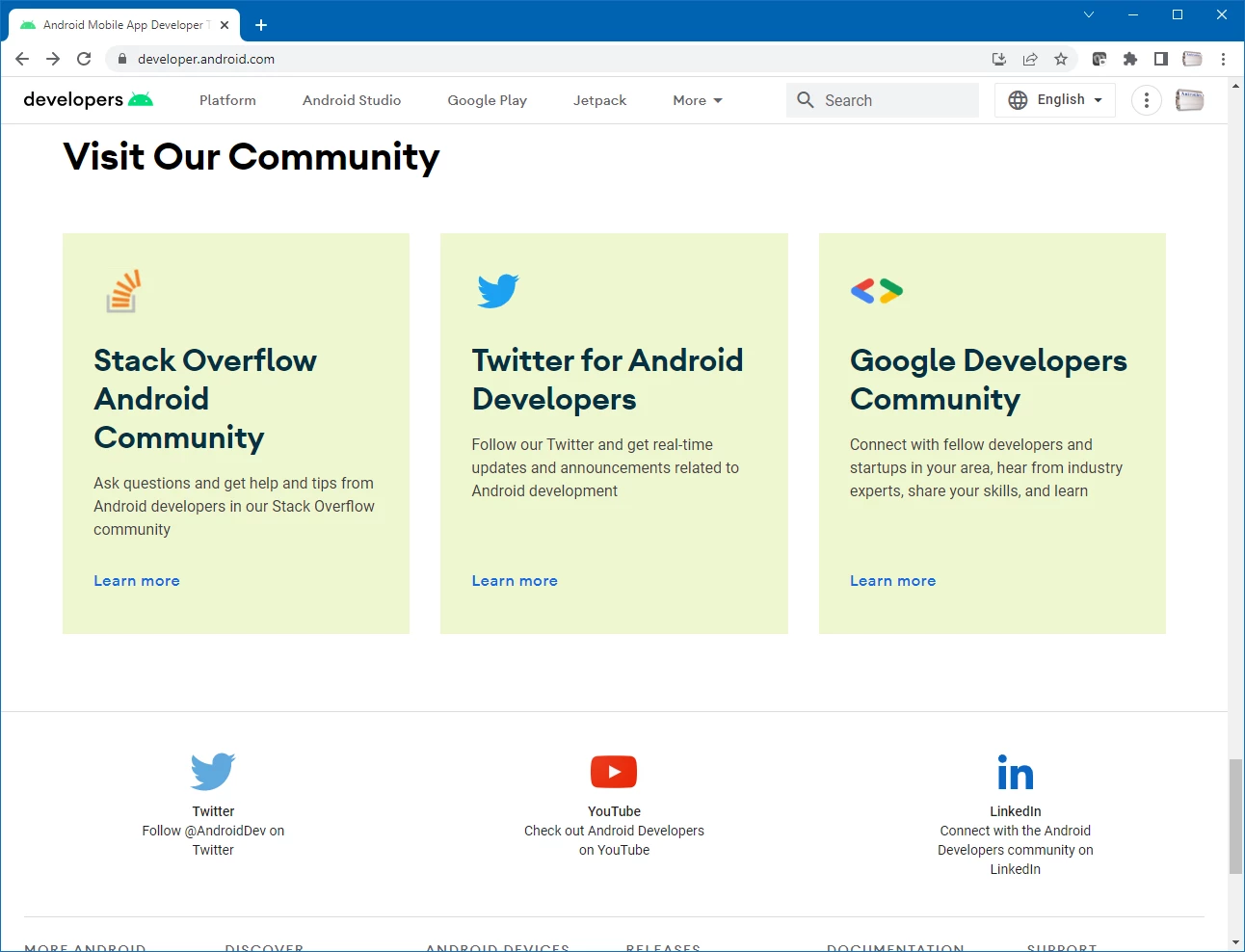

Andrew Neil
Jul 14, 2022 3:23 PM UTC
You need an Android forum for this:
