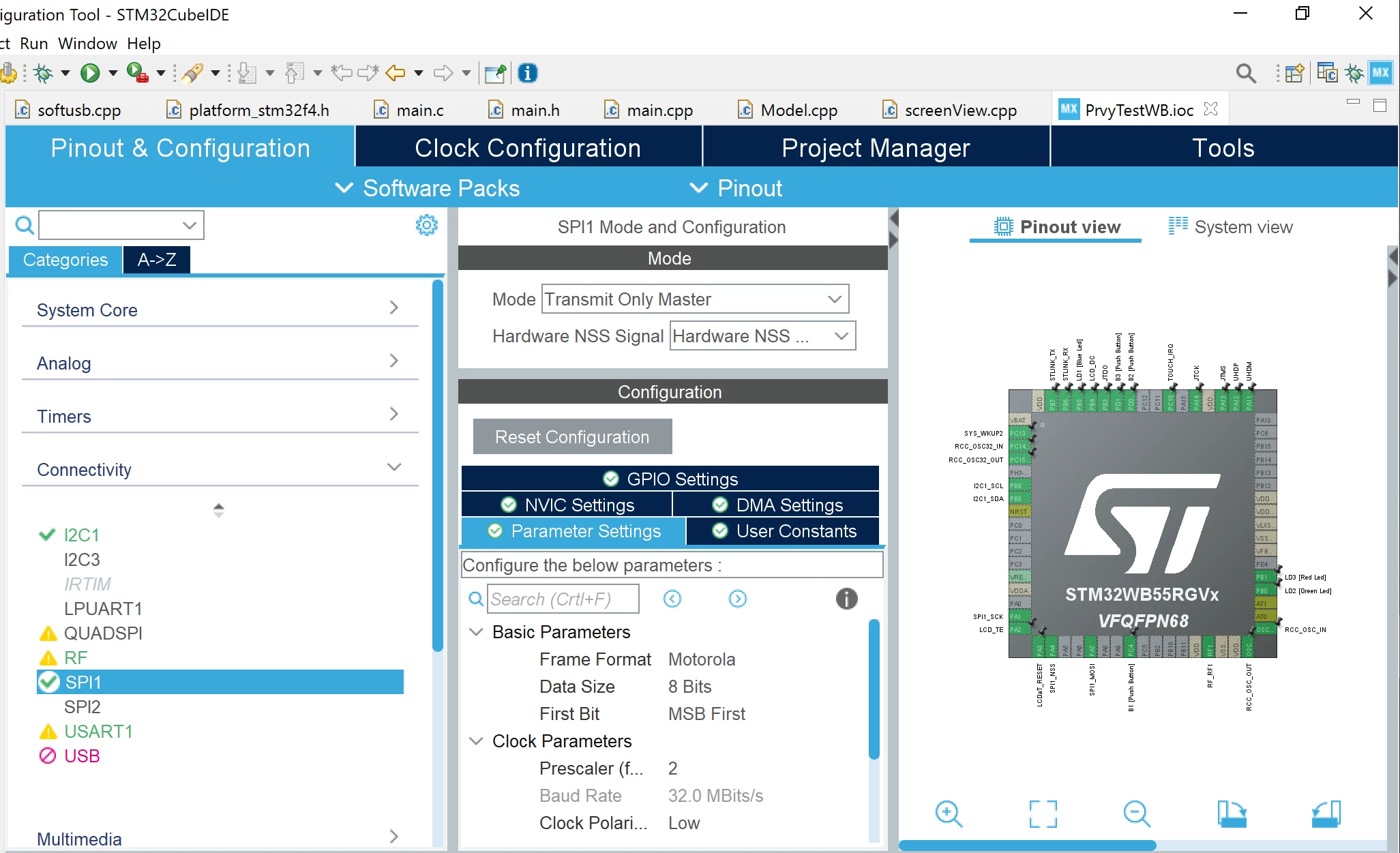

How to enable SPI in STM32WB5MMG using STMCubeIDE?
We made a custom PCB board using STM32WB5MMG. We tried connecting with ADS1299 using SPI, but we are new to this controller. So we didn't know how to enable SPI and transfer and receive data from it.

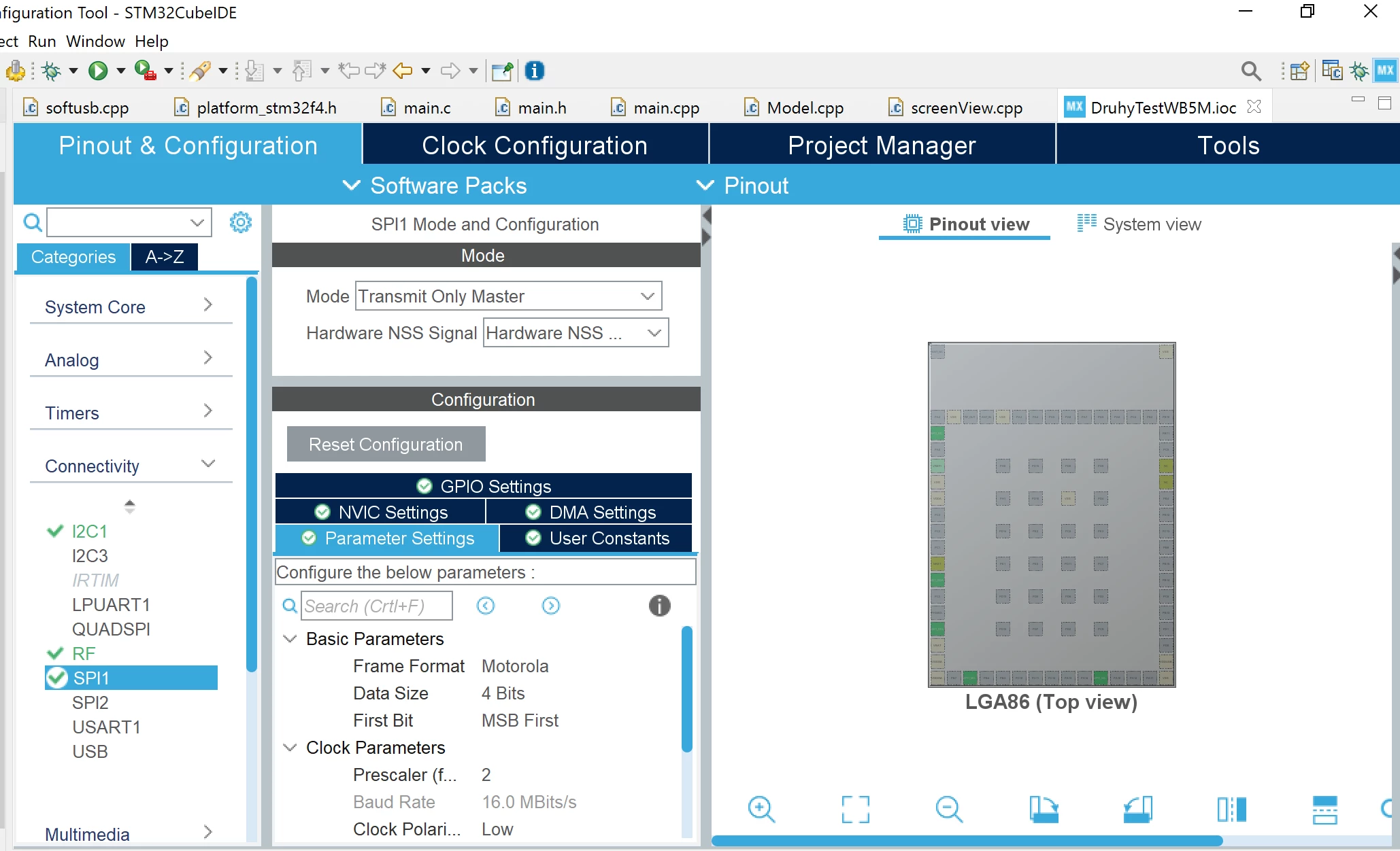

MM..1
Jan 23, 2023 12:16 PM UTC
Stm32cubeIDE have same wizard for config board simply click on SPI and setup for example
