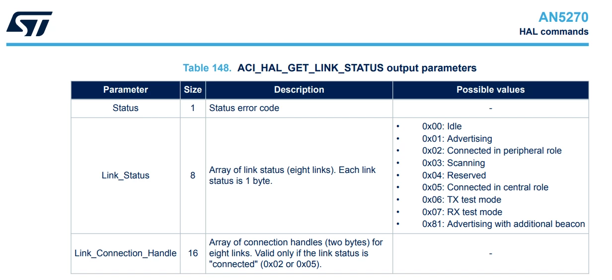

how to do an operation on specific BLE link
ACI_HAL_GET_LINK_STATUS will give an Array of link status (eight links).
My question is how do I do operations on specific links of my choice?
e.g., start an advertisement on a specific link.
reference AN5270 -

Hi DS.4,
You can look at the p2pRouter example, which allows you to control multiple device servers via a client device.
The idea is to use the Connection Handle to perform specific operations on the different links.
BLE_p2pRouteur
I hope it will help you. If you have any other questions later, don't hesitate to come back to me.
Joé, BR.

Ok, I think I understand.
When connected - I need to search the connection-handle-array. My specific handle will be in the index of the link.
But what if I am not connected yet?
On advertising start, one of the links will turn to 'Advertising' status,  what link will it be? Is there a rule? Should I sample it after advertising starts? What if that link gets connected and I start advertising again, what link will turn 'Advertising' now?  I mean you should probably have a clearer answer on how this works!
