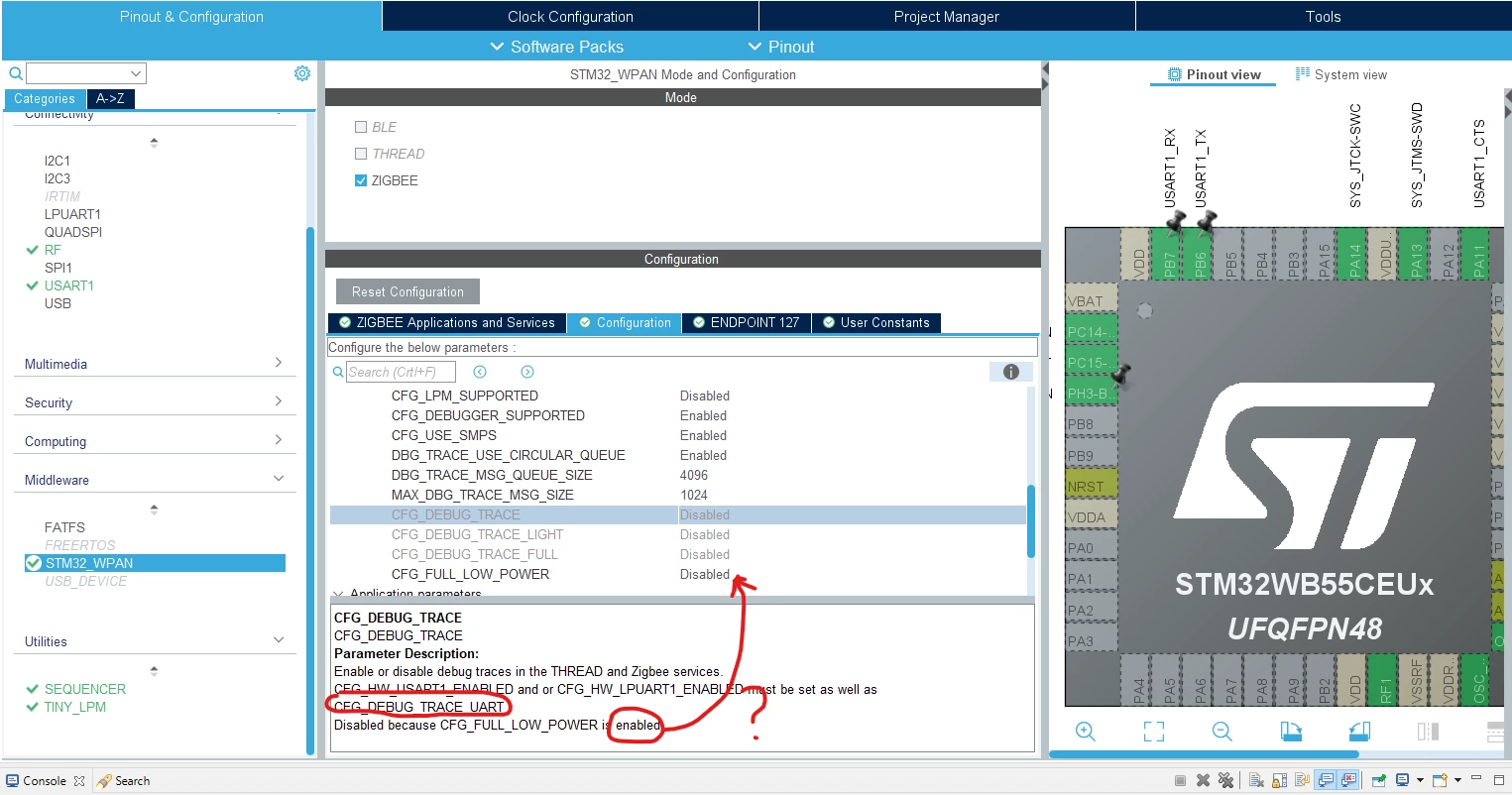

Moreover, I can't figure out to enable UART debug trace via STM32CubeIDE because CFG_DEBUG_TRACE_UART need to be enabled but is not available any where in the configuration tool and it tells me that the CFG_FULL_LOW_POWER is enables but it's not
Here is a screenshot...
0693W00000BZyA0QAL.pngThanks in advance.
Have a nice day.

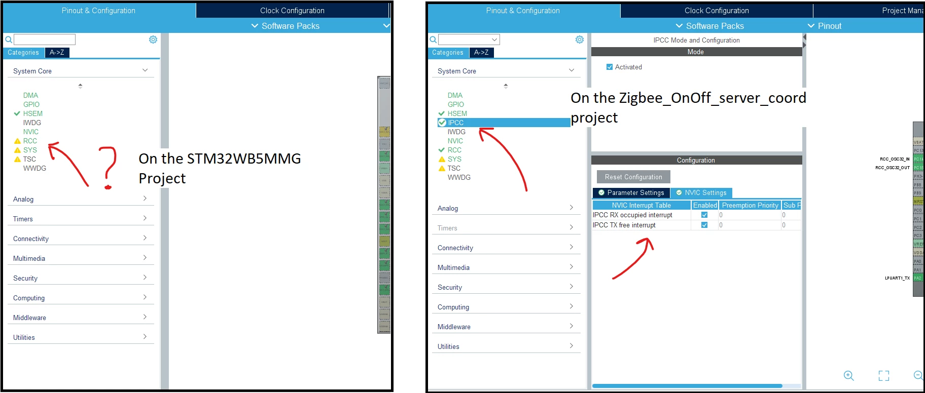

Regarding the Zigbee application development, I found something weird, I tried debugging my application code on an stm32wb5mmg and the example application Zigbee_OnOff_server_coord trying to find the differences and the code is exactly the same, but, In the example, after all the zigbee initializations, it periodically receive an interrupt comming from the M0 via IPCC_C1_RX_IRQHandler (which seems quite logical for me), while in my application I never receive any interrupts from the M0.
Moreover, in my application, I'm not able to add or configure IPCC in the code generator configuration (i's not available in the peripherals as shown in the screenshot),
So I manually add the handlers in the stm32wbxx_it.c file :

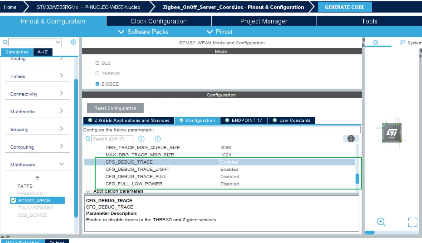

  • For the first point you raised, you're absolutely right, CFG_DEBUG_TRACE_UART is not listed in Application parameters when ZIGBEE mode is selected. This is will be reported internally to be fixed as soon as possible.
Note that starting a project based on Zigbee_OnOff_Server_Coord / Zigbee_OnOff_Client_Router examples, CFG_DEBUG_TRACE parameter will be enabled by default:
  • For the second issue, IPCC will be supported for STM32WB5MMGHx MCU in a near future release of STM32CubeMX.
Noting that Zigbee_OnOff_Server_Coord / Zigbee_OnOff_Client_Router are based on STM32WB55RGVx MCU supporting IPCC in the current CubeMX version.
