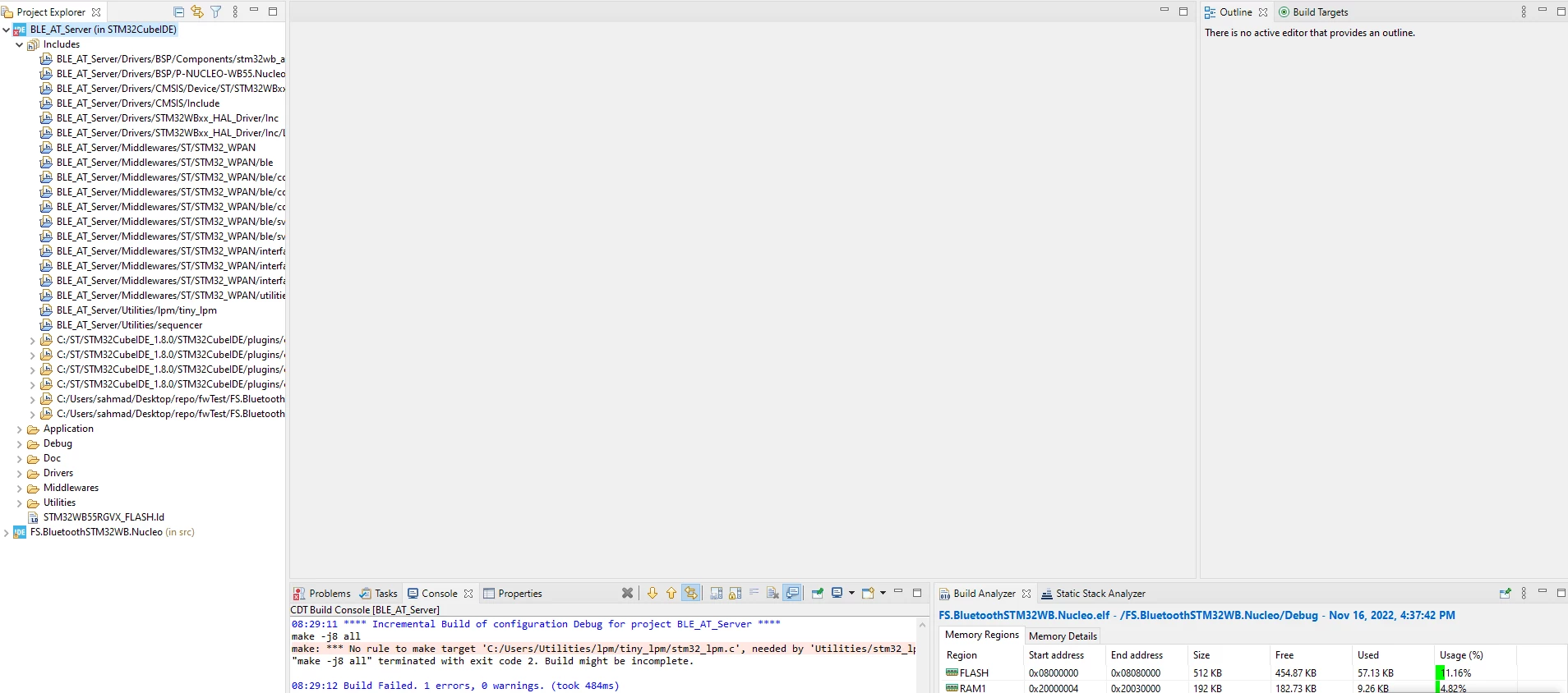

I have gone through this example several times and when I try to compile and run the code it prompts some errors and I am unable to execute it.
Bob S
Nov 16, 2022 2:38 PM UTC
Looks like a makefile/IDE config issue. Is this a CubeIDE project? That path looks like it is outside your IDE project path, unless your entire project is under C:/Users/Utilities.
If using CubeIDE and want this code compiled as part of your project (as opposed to a separately compiled library), it needs to be in/under your project directory, like this:
C:/MyProject/src
C:/MyProject/lpm
SAhma.5
SAhma.5Author
Nov 17, 2022 7:30 AM UTC
I have solved the path issues but still error exists. Here is the screenshot.0693W00000WId0jQAD.png
Remy ISSALYS
Nov 17, 2022 8:32 AM UTC
Can you try with the latest STM32CubeWB package (v1.14.1) and the latest version of STM32CubeIDE (v1.10.1)?
