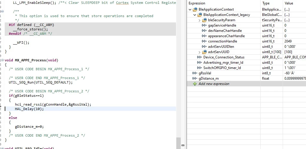

          In My Project  I have to findout the distance between BLE Master(p2p Server) and Slave(p2p Slave) using STM32WB5MMG and i got the RSSI value using api hci_read_rssi() ,anyone help me to convert RSSI value into distance.
  p2p Server  TxPower +3dB and p2p Client TxPower is  -0.15dbB

You can't.
RSSI is affected by so many things that the best you'll achieve in practice is just a very broad "near" or "far" guesstimate.

I thought ,the one of the  main action of STM32WB series is tracking ble device and tracking ble device using rssi is possible ?
Andrew Neil
Apr 22, 2024 11:39 AM UTC
Only very crudely using RSSI alone.
