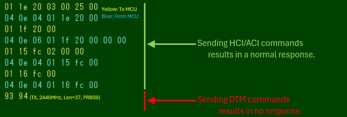

I want to use the 2-wire Direct Test Mode defined in Bluetooth Core Spec Vol. 6 Part F for RF testing of my STM32WBA custom board.
I've already tried BLE_TransparentMode. While HCI / ACI commands work, DTM commands don't respond.
Is it impossible to control with 2-wire DTM commands in BLE_TransparentMode?
Please let me know if there's any way to do this.

Your target is to use WBA device as a pure network processor and interface it from external host MUC ?
If so indeed WBA need to be loaded with transparent mode image, this topology is named Network processor approach and you would be able to find some host mcu code here : X-CUBE-WBA | Product - STMicroelectronics

Since there are no sample projects that support DTM commands, I understand that I should either use HCI commands or create my own component to convert between HCI and DTM.
