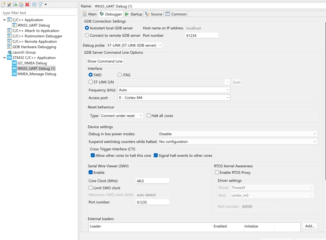

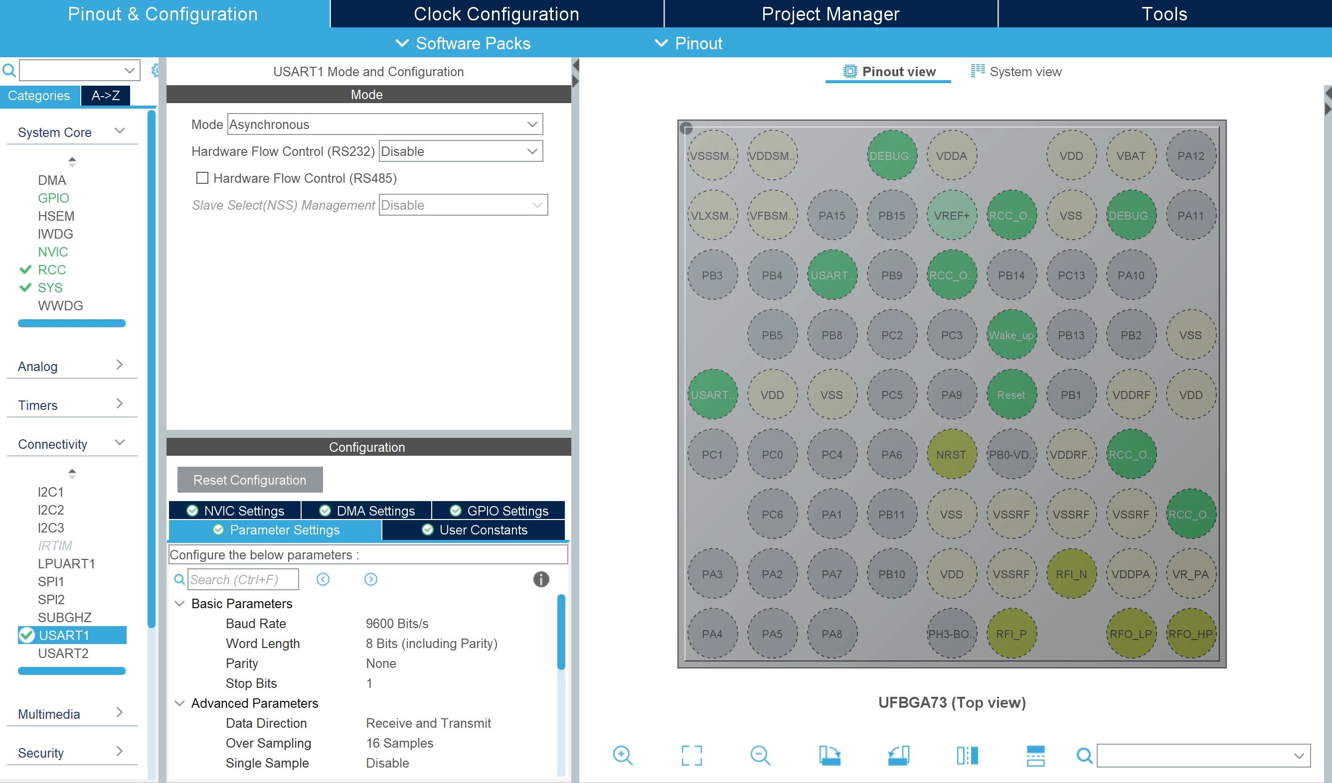

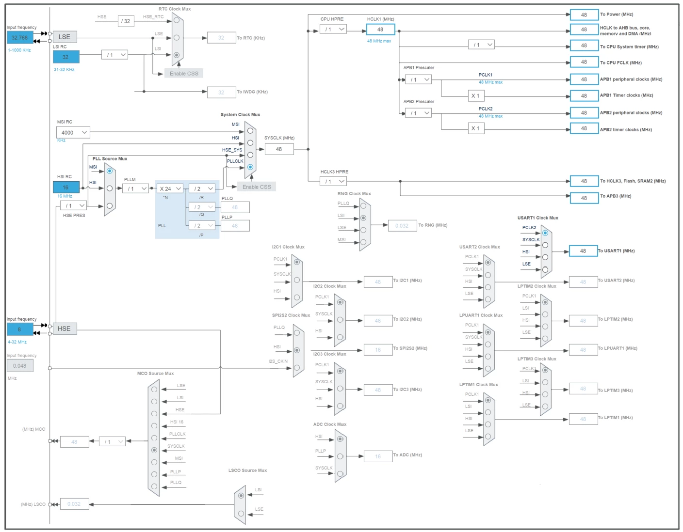

Pin configuration and the settings are as follows:
Clock configuration:
_legacyfs_online_stmicro_images_0693W00000bVj6nQAC.pngDebugger configuration:
Please let me know if you need more information to for helping me in solving this issue.
