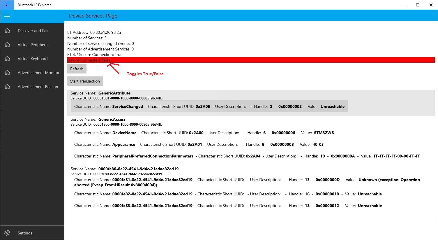

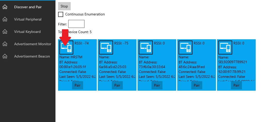

Now I tried different apps on my Win10 PC to connect this example. For example I used "Bluetooth LE Lab" or "Bluetooth LE Explorer" to connect my board.
For example with "Bluetooth LE Explorer" it comes in the Debug Output above till line 30 (change ATT MTU size) then there is a "DISCONNECTION COMPLETE" event and then it stats again from line 19 (DATA THROUGHPUT PROJECT) and goes to line 30 and disconnection again. This repeats till I stop. In Bluetooth LE Explorer it also toggles "Device Connected:" between True/False

They also used the "Bluetooth LE Explorer" there to connect the STM32WB with the example BLE_HeartRate. So I also tried this example but it's not working with "Bluetooth LE Explorer". Same problems as described above. The output of the "Bluetooth LE Explorer" looks a little bit different, then on the webpage. I attached my output Bluetooth_LE_Explorer__BLE_HeartRate.jpg
