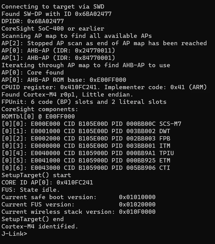

I made a breakout board using the STM32WB5MMG with SWD debugging.
I have confirmed that the SWD pins are working.
I have also set up HSEM, IPCC, RCC, RTC, RF, STM32_WPAN required but I can't detect the Bluetooth

Hi @SWong.10​ , what firmware are you using?

Hi @Lotta​ ,
I follow the guidelines on :
For Firmware (V1.2.0):
stm32wb5x_FUS_fw.bin at address 0x080EC000
For Wireless (V1.15.0):
stm32wb5x_BLE_Stack_full_fw.bin at address 0x080CE000
The following shows the J-Link Commander:

Sorry for the late response due to personal reason. The problem has been solved.
STM32CubeIDE Version: V11.1.0
Follow the guidelines on :
Remember to make sure that the wireless stack is started.
The problem I faced was the clock configuration for RFWKP Clock Mux. Previously, LSE was selected but the Bluetooth did not work. Thus, using HSE instead of LSE for the RFWKP works for me.
