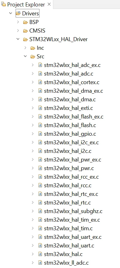

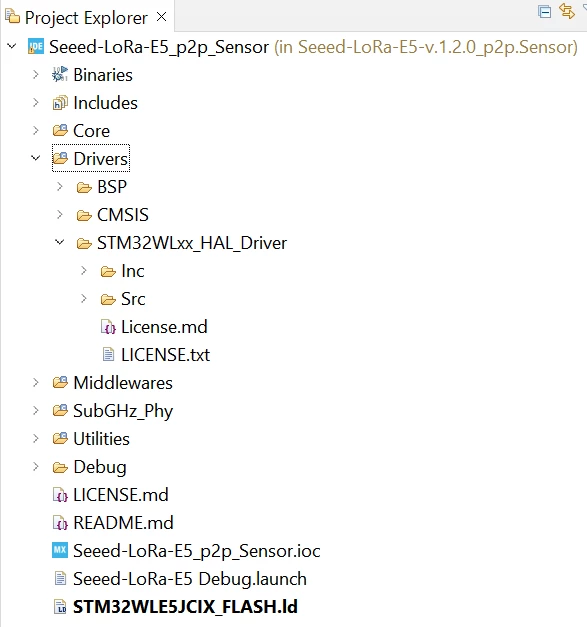

How to check what version is STM32WLxx_HAL_Driver?
I got this from github.  It compiles ok.  The package has source for STM32WLxx_HAL_Driver.  How can I find out what version is the STM32WLxx_HAL_Driver?  TIA
