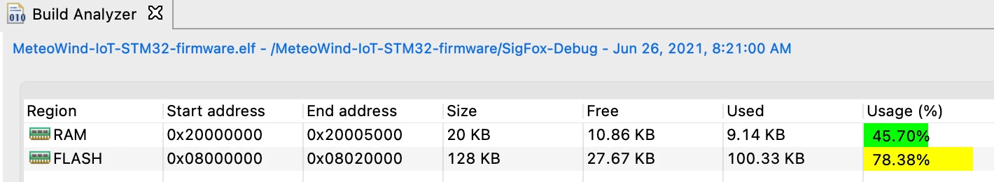

You can access that information from the Build Analyzer view.
If you search for "Build Analyzer" in the Quick Access search bar you can open that view.

The Build Analyzer is only available in STM32CubeIDE, not in SW4STM32.
I misunderstood because the forum post has the tag/topic "STM32CubeIDE" so I thought that was the tool in question.

0693W00000Bc3xLQAR.pngSame as Markus, but accessed different way: Window/Show View/Build Analyzer (I use STM32CubeIDE 1.6.1)

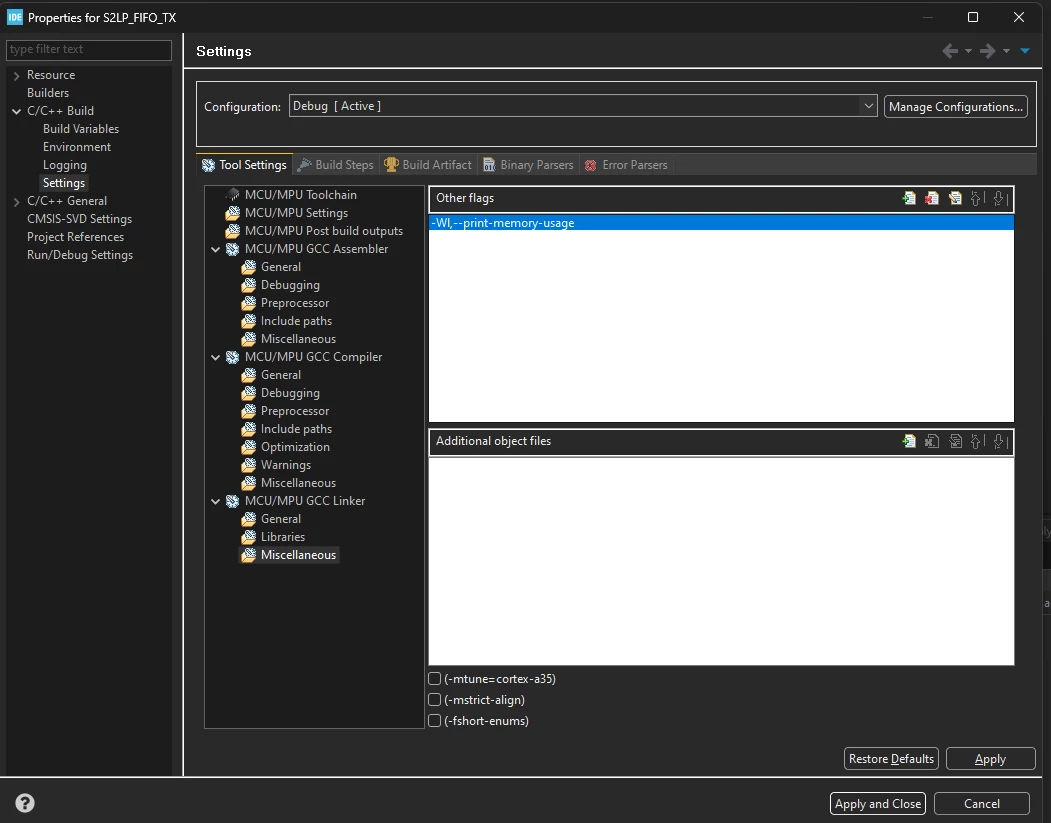

Hey,
you could add the linker option -Wl,--print-memory-usage to your project properties.

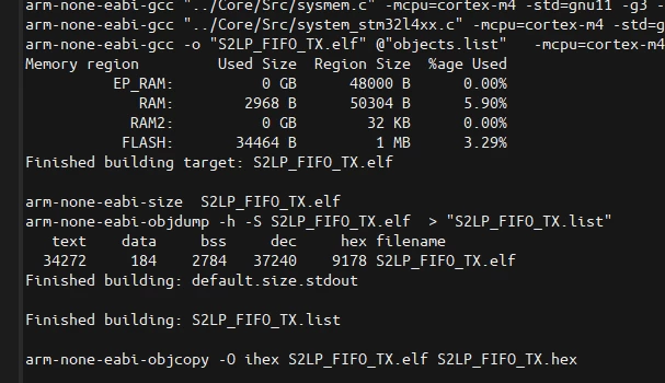

This will produce an output that looks something like this:
