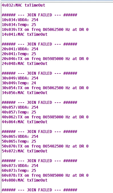

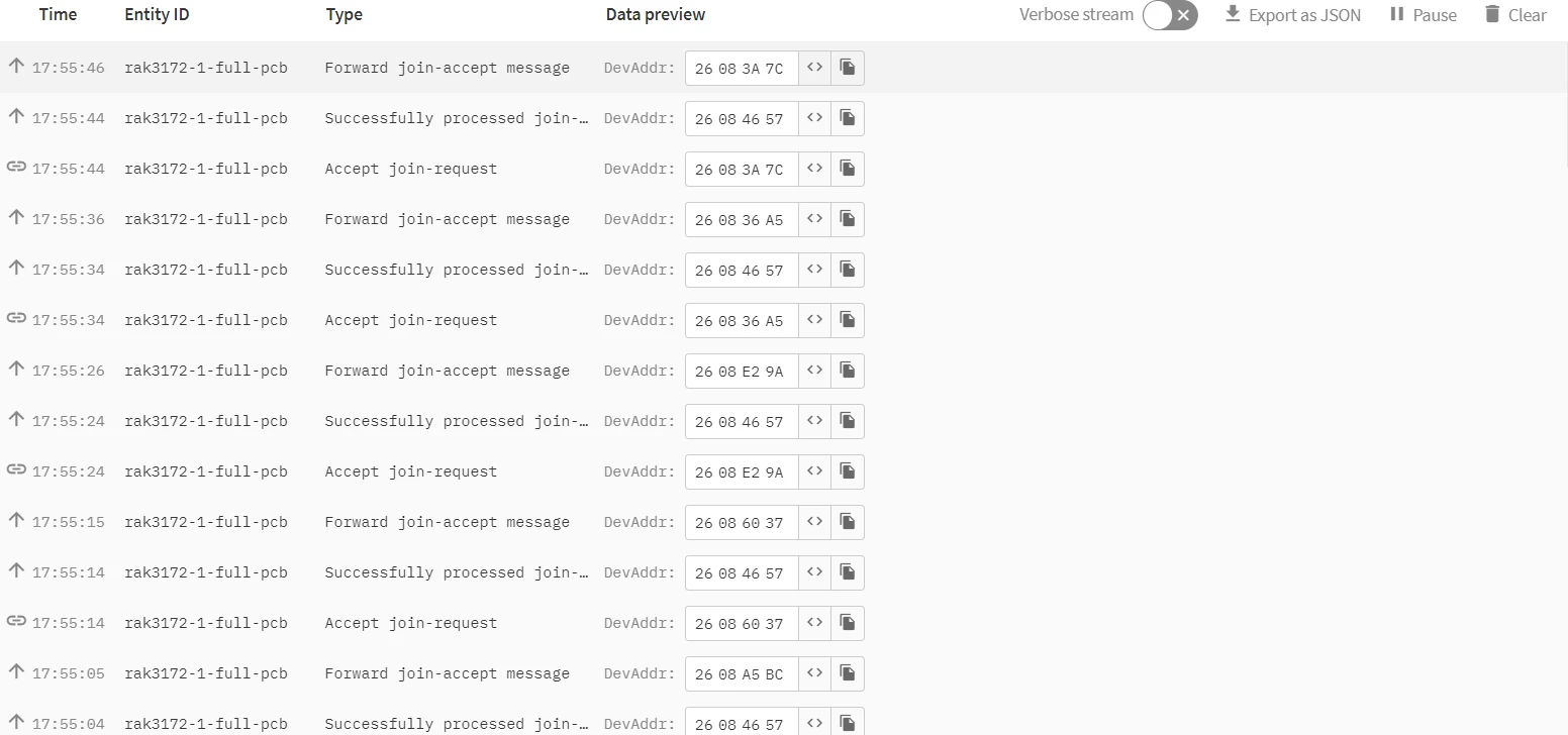

Thanks for replying, yes I understood your suggestion, but I should elaborate the scenario.
The module is joining successfully to the network server, as it can be seen
TTN server endTTN server endSo, I guess the Sub_Ghz / RF section is working fine, but the MCU section is not receiving any successful Tx return status from the RF sectiono, so it is trying to join again and again
Serial log of moduleSerial log of module
What could be the possible issue?
