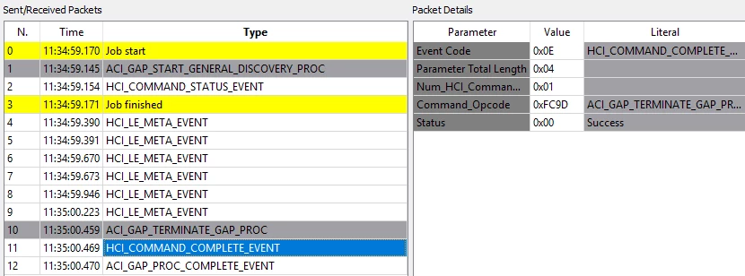

Winfred LU
Nov 4, 2020 3:38 AM UTC
ACI_GAP_TERMINATE_GAP_PROC shall work.
Attached the screenshot terminating the scanning after 1 second.
Aishwarya
Nov 4, 2020 9:33 AM UTC
yes @Winfred LU
Open Winfred LU Preview
 I fallow the same steps but aci_gap_terminate_pro(0x02)  function returns status ERR_NOT_ALLOW.
Winfred LU
Nov 9, 2020 2:34 AM UTC
Please refer to AN5270 - STM32WB Bluetooth® Low Energy (BLE) wireless interface
https://www.st.com/resource/en/application_note/dm00571230-stm32wb-bluetooth-low-energy-ble-wireless-interface-stmicroelectronics.pdf
section 2.4.23 ACI_GAP_START_GENERAL_DISCOVERY_PROC
The procedure is terminated when either the upper layers issue a command to terminate the procedure by issuing the command ACI_GAP_TERMINATE_GAP_PROC with the procedure code set to 0x02 or a timeout happens (the timeout value is fixed at 10.24 s).
Please note that there is different ACI called ACI_GAP_TERMINATE, which is used to terminate the connection. Don't get confused with ACI_GAP_TERMINATE_GAP_PROC .
