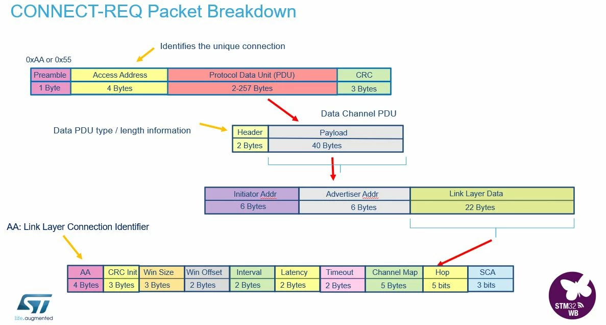

How to change BLE Access Address without using Low Level Driver
How do I change the BLE Access Address?(default 0x8e89bed6)
LLD can be changed through a function called HAL_BLE_LLD_Configure, but there are no functions to change the channel and access address other than that.
Is it possible to change the access address without LLD?
Sorry for using a translator.

Hello @세박.1
I suggest you to lock in the reference manual. Than change you BLE access address using direct access register programming.
Hope this is helpful. If your question is answered please check it as best answer to be diffused.
Best regards.
