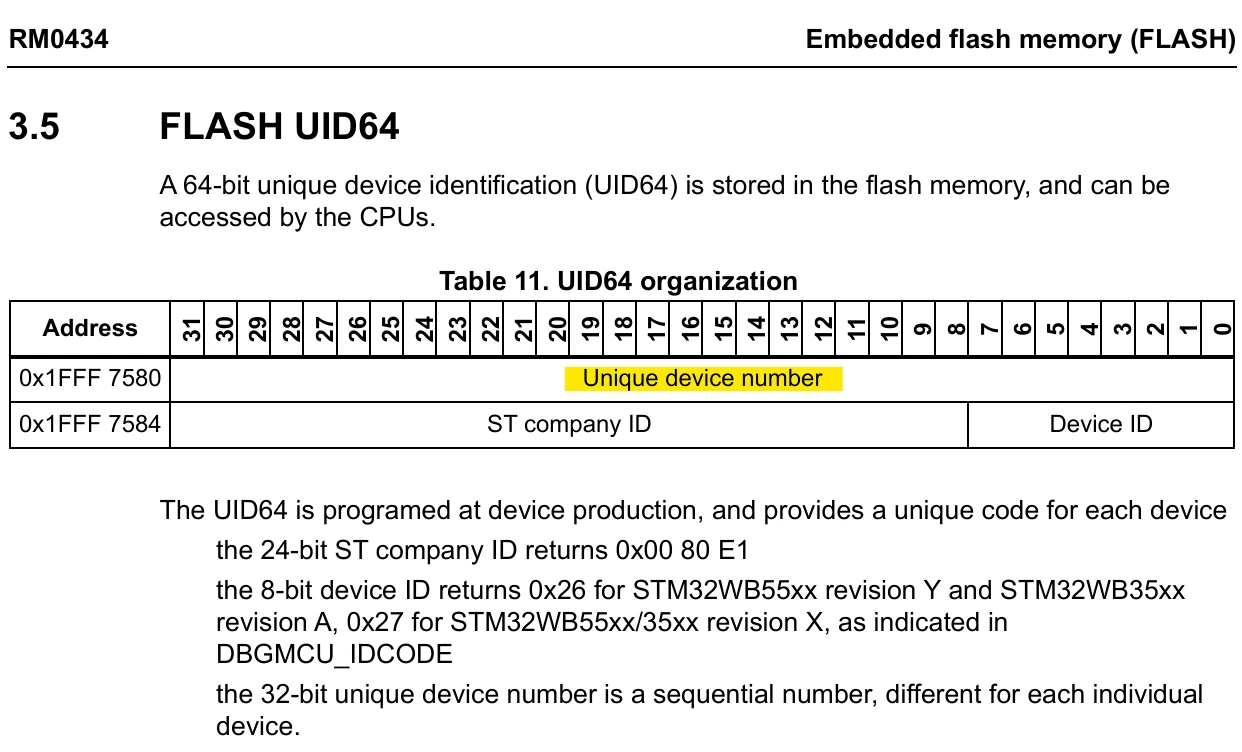

If your intention is to generate a unique number to identify the device, I suggest using what's already onboard for that. The UID64 register value is guaranteed unique for each device.
Barring that, there certainly are ways to save information. Saving to a flash sector can work, as can saving to SRAM if power is not lost.

Thanks to you I have a better understanding of UID.
This time, however, I would like to add a process to change the random static address when a new connection is initiated after this (pressing the pairing button again during pairing).
Therefore, I don't think UID can be used only for identification (not sure if this is correct, sorry).
I'll think about how and when to save it to flash some more. Thanks.
