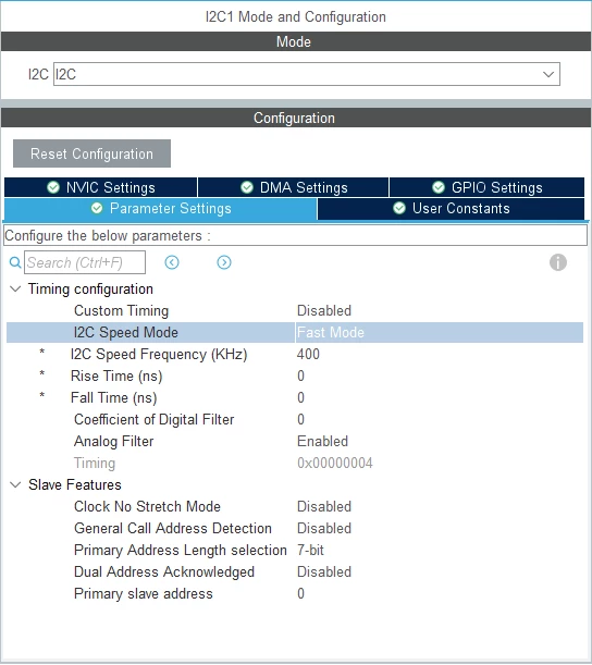

Foued_KH
Dec 8, 2022 2:55 PM UTC
For the Timing register value : 0x00000E14, the Rise Time = 0 ns and the Fall time = 0 ns too,
For example : for Fast mode (400KHz) :
0693W00000WKZDSQA5.pngthis timing register value is generated automatically by the STM32CubeMX.
Foued

Foued_KH
Dec 8, 2022 3:31 PM UTC
The timing register value is 0x00000004 generated automatically by the STM32CubeMX for :
  • I2C Clock Source Frequency : 4MHz
  • I2C Speed Frequency : 400 KHz
  • Rise Time : 0 ns
  • Fall Time : 0 ns
Foued

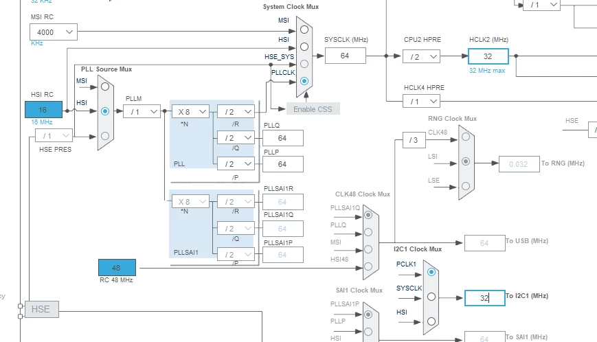

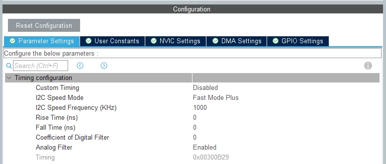

Foued_KH
Dec 9, 2022 10:11 AM UTC
Example description:
-I2C pins
  • SCL Pin: PB8 (CN10, pin3)
  • SDA Pin: PB9 (CN10, pin5)
-I2C Clock Source Frequency : 32 MHz
0693W00000WKdxPQAT.png-I2C Speed Frequency : 1MHz
-Rise Time : 0 ns
-Fall Time : 0 ns
  • TIMING REGISTER = 0x00100413

User16669512935851271792
Dec 9, 2022 11:09 AM UTC
Hi Khalsi,
Once again thanks for your support and sharing the source code to us.
Almost code is the same except the Clock Source settings, in your code RCC_ClkInitStruct.SYSCLKSource = RCC_SYSCLKSOURCE_PLLCLK.
our code,
RCC_ClkInitStruct.SYSCLKSource = RCC_SYSCLKSOURCE_HSE.
but the Input Clock to I2C1 is 32 MHz Only, Mx settings also same. We will use Same Timing Reg value for our as well.
