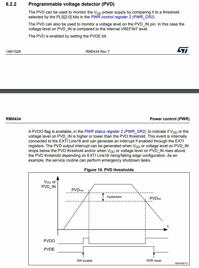

How do I set up the PVD and start?
I am using the Nucleo WB55 Development Board, how do I set up the (Programmable voltage detector) PVD and get it to work?
Imen.DBest answer
May 11, 2021 7:46 AM UTC
Hello @Member​ ,
I advise you to read RM0434 : 6.2.2 Programmable voltage detector (PVD) section.
When your question is answered, please close this topic by choosing Select as Best. This will help other users find that answer faster.
Imen
