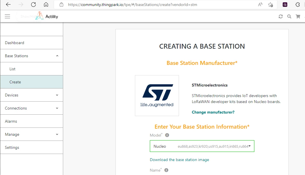

For the Actility firmware, once you are connected, you can go in the Base Stations tab, Create, and once you choose STMicroelectronics manufacturer and your model, you can download the base station image.
You have also a direct link here.
Best regards
