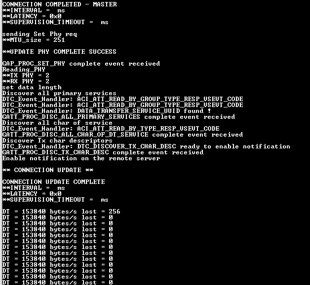

RNiel.2
April 12, 2021
When I tried the example back in February I managed to get a throughput of 171 kBytes/s (close to theoretical maximum). I have since tried to recreate the performance with a custom service, though without any luck as my throughput is limited to 47 kBytes/s. So I tried to go back to the data throughput example to see what I did differently.
Going back to the data throughput example I can now reach a maximum of 153 kBytes/s with the following settings.
In app_conf.h
#define CFG_TX_PHY  2
#define CFG_RX_PHY  2
In app_ble.c -> Connection_Update(void)
I changed the CONN_P1_400 and CONN_P2_400 to CONN_P2_50 and CONN_P2_50. I know data throughput should be best at 400 ms but I got better results this way.
And most importantly I build the project with release setting instead of debug, in CubeIDE. This increased both the throughput and stability of the connection.
Does these settings help you, @DHunt.1​ and @SStoy.1​ ?
(I still haven't managed to increase throughput on my custom service above the 47 kBytes/s)

RNiel.2
April 14, 2021
Weird it didn't work, I'll upload my project. Hope this works for you!
Yes, I did refer to the hammer icon release build.
This is the output I receive from the dongle
0693W000008zUFFQA2.png/Robert
