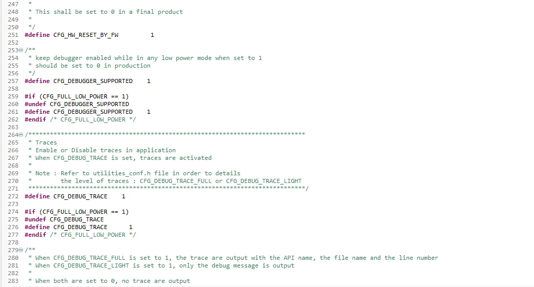

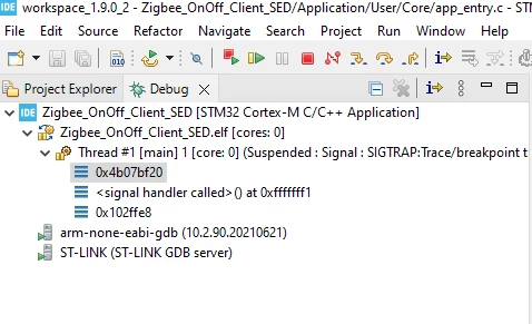

How can I to debug STM32WB5MMGH6TR module in STOP2 mode. I use HAL_DBGMCU_EnableDBGStopMode() but my ST-LINK debugger lost connection with module.

Can you check if the following define is set to 1 in app_conf.h ?
#define CFG_DEBUGGER_SUPPORTED 1

Maxim Shylo
June 28, 2022
