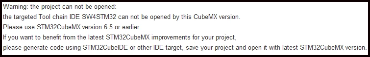

How can I open this project which was created using older STM32CubeIDE and MX
https://github.com/leechwort/u8g2-stm32-example/tree/master
Any advises on opening this?  I brought the needed Hardware Nucleo F401RE.  However the latest IDE and MX are not able to read the project.
What is the general advises and procedure to port between different STM32 MCU under HAL or LL?  Is HAL easier than LL for porting between different 'relatively modern' MCU?
If the project will be successfully open, what need to be done to port it from Nucleo F401RE to STM32WLE5JCI6?  These two MCU are same ARM M4 series, right?

For this project, I suggest you open the .ioc file and generate the project starting from this file. Then, you can add the necessary code on the generated files.
The Hal is surely easier for migration between MCUs since it is almost the same between the MCUs.
For Migration between STM32F4 and the STM32WL you can use the recommendation of both AN4821 and AN5408.

Many thanks.  I brought a Nucleo STM32F103RB to follow this in Github here
It was in STM32F103C8T6 which I hope is close enough to the Nuceleo board.
Out first task is the setup the Nucleo in same configuration as the example.  Cannot read .ioc is the problem.
Wonder if you factory has tools to read the older .ioc (or may just see the generate init code).  If you can, please generate an .ioc file using current version MX and attach in your reply.

The error message says it clearly:
Open the .ioc file in text editor and delete two lines that contain "SW4STM32". Save the file, open with CubeMX again.
Same with the other github project: delete lines that contain "TrueStudio".

This is a very sorry state of affairs. Should be able to read OLD projects regardless if they changed or fixed the formatting / processing. Bug fixes should include fixing the mess you've made previously, and do it seamlessly. Should be able to RECOVER corrupt ones, or IMPORT older versions. This is what normal tool vendors do. They also support competitive products to steal their customers and make the process as painless as possible.

Agree. The standalone CubeMX should offer conversion to a supported IDE from unsupported. But it was easy to fix manually))
