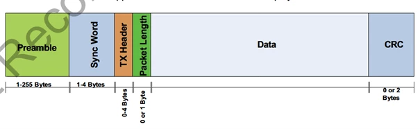

How can i add a 2-byte transmit header to the wireless message.
I am trying to get the NUCLEO-WL55JC radio backwards compatible with our previous radios protocol used in the SI4432 and the EFR32xx from silicon labs. Most of it is already working but I can not add a transmit header in the message. This transmit header are two extra control bytes placed between the sync-word and the length byte.
The transmit header is included in the CRC and data whitening, so I can not combine the transmit header with the sync word.
Is there any possibility to add these two bytes in the wireless message, I do not care if I have to manually check the transmit header and/or packet length. The main goal is to make this radio backwards compatible.

-         GFSK modulation
-         868 MHz base frequency
-         2 bytes sync-word
-         2 bytes transmit header
-         1 bytes packet length
-         Variable packet length
-         CRC16
-         Using CRC over: Transmit header, Packet length and data.
-         Using data whitening over: Transmit header, Packet length, data and CRC.

Hi @Bvan .9​ ,
You can do that manually indeed.
You can find some useful material below, although not complying entirely with your packet format requirements:
https://www.st.com/resource/en/application_note/an5687-longpacket-operation-with-stm32cubewl-stmicroelectronics.pdf

Hi @YBOUV.1​ ,
I've managed to do this manually and I can succesfully transmit messages, thank you for your help and information.
