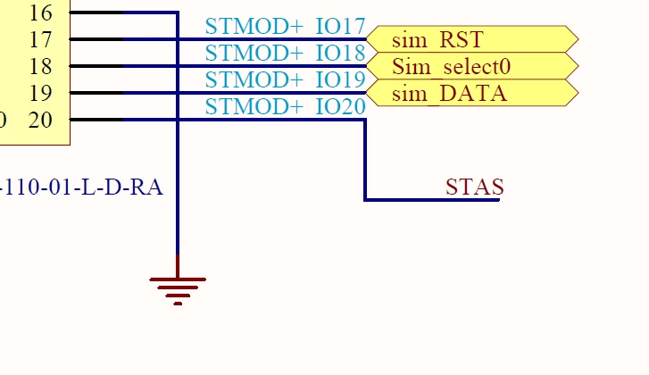

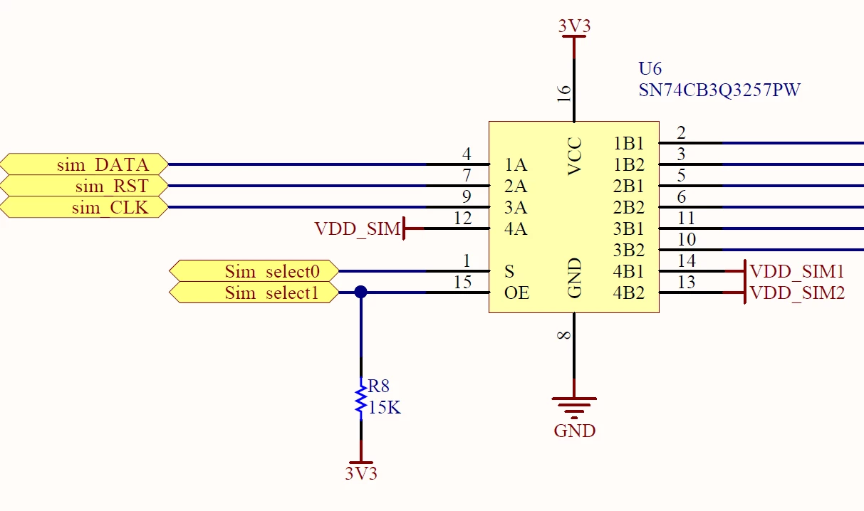

Hy, we struggle to get P-L496G-CELL02 up and running. We created a Cube IDE Software project and are able to send AT commands to BG96. Now we entered a plastic SIM from 1nce and try to connect. Unfortunately we can not select plastic SIM. There is a bus switch (U6) on BG96 board and we net to set signal Sim_select0 to "0".
_legacyfs_online_stmicro_images_0693W00000bjwgXQAQ.pngSim_select0 is available on pin 18 of the 20 pin connector from BG96 board to STM32 board

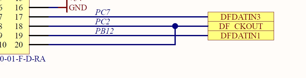

But on the STM32 board, Pin 20 and Pin 18 are connected.
_legacyfs_online_stmicro_images_0693W00000bjwinQAA.pngSo whenever BG96 asserts the "Status" signal (which it does right after boot), embedded SIM is selected.
Why is Pin 18 and Pin 20 connected on STM32 board? What do I need to do to select plastic SIM?

You have to cut pin 20 to use the plastic SIM and reroute the STAS it to a free pin if you absolutly need to monitor that signal.
Additionally, I have been told the firmware X-CUBE-CELLULAR software package does not use STAS signal coming from the modem, so it seems to be optional.
This is what we did in the mean time. But it doesn't make any sense, does it? Why would you double-use this essential pin? Is this just a design flaw?
