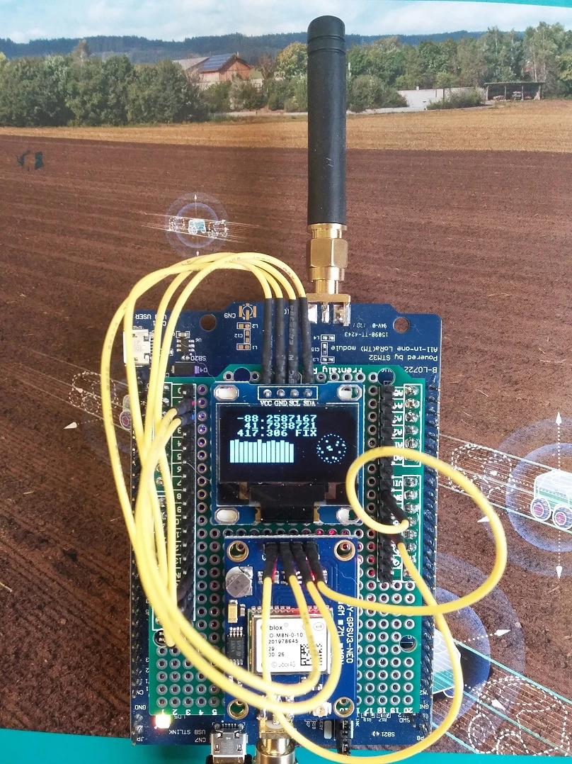

I added GPS and OLED display without using CubeMX
