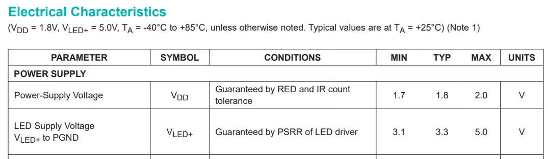

The MAX30102 operates on a single 1.8V power supply and a separate 3.3V power supply for the internal LEDs. (DATASHEET)
0693W00000Y8twCQAR.png So, try to provide 1V8 as a power supply for the sensor MAX30102.

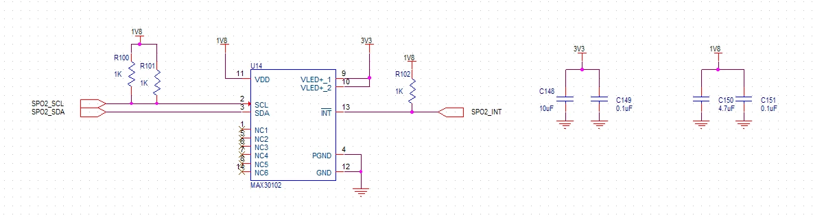

AJAY S
AJAY SAuthor
Jan 23, 2023 10:11 AM UTC
this is my shematic design sir here i2c i use 1v8 is that okey to communicate STM32WBMMG chip. in between 3v3 to 1v8 level shifter is required? or not thats my doubt0693W00000Y8u5EQAR.png

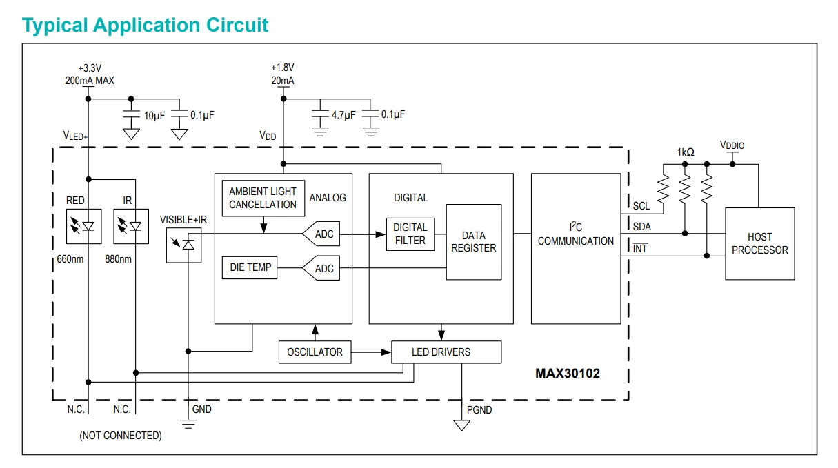

Foued_KH
Jan 23, 2023 10:40 AM UTC
I think you are alright as recommended in the Datasheet of the sensor MAX30102 :
0693W00000Y8uG7QAJ.pngFoued
AJAY S
AJAY SAuthor
Jan 23, 2023 10:42 AM UTC
MY host is 3V3 sir,but my sensor is 1v8 thats why i had confussion.

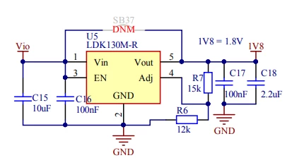

Foued_KH
Jan 23, 2023 10:50 AM UTC
Try to use a regulator to provide 1V8 like the LDK130M-R.
0693W00000Y8uIhQAJ.pngI advice you take a look : Schematic diagram Motion MEMS and environmental sensor expansion board for STM32 Nucleo -

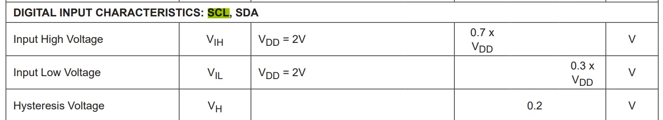

MM..1
Jan 23, 2023 12:40 PM UTC
You can use it , because is in max ratings but need have this levels in range primary low under ...0693W00000Y8uwwQAB.pngas you see High dont have defined up limit ... abs max ratings is 6V
