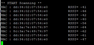

Hello, I'm using STM32WB to scan bel beacons, i started from p2p_client example and modified it to scan all types of beacons it shows all close blutooth devices, their MAC and RSSI power, but i want to show more beacons info like name, type, tempertu

0693W00000LvyRZQAZ.pngDo anyone have an idea please, what should i add to the code so that i can get all beacon information
1 reply

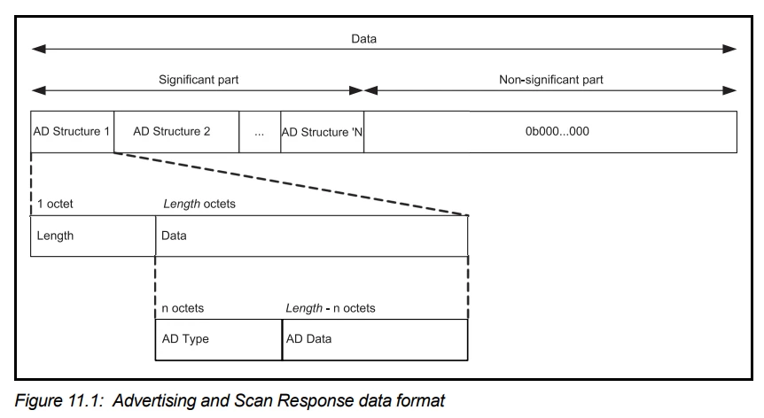

Remy ISSALYS
Apr 6, 2022 2:56 PM UTC
You have to parse advertising data (adv_report_data) to recover your data. Advertising data have the following structure (see BLUETOOTH CORE SPECIFICATION Version 5.2 | Vol 3, Part C) :
0693W00000Lx7I9QAJ.pngYou have to use this with different offset:
adv_report_data = (uint8_t*)(&le_advertising_event->Advertising_Report[0].Length_Data)+offset;
A description of each AD type is available in this document:
https://btprodspecificationrefs.blob.core.windows.net/assigned-numbers/Assigned%20Number%20Types/Generic%20Access%20Profile.pdf
Best Regards
