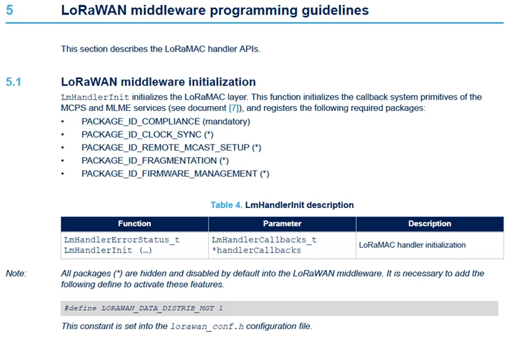

You have to enable this package by calling the function LmHandlerPackageRegister (PACKAGE_ID_REMOTE_MCAST_SETUP, NULL) define in LmhpPackagesRegistration.c.
This will allow the device to support LoRa MAC commands related to multicast.

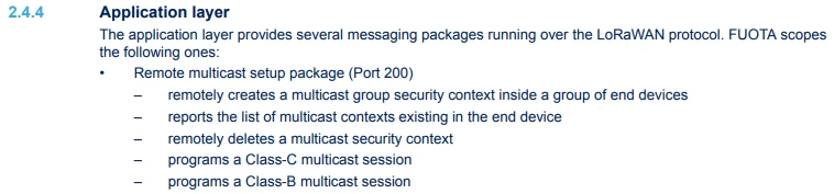

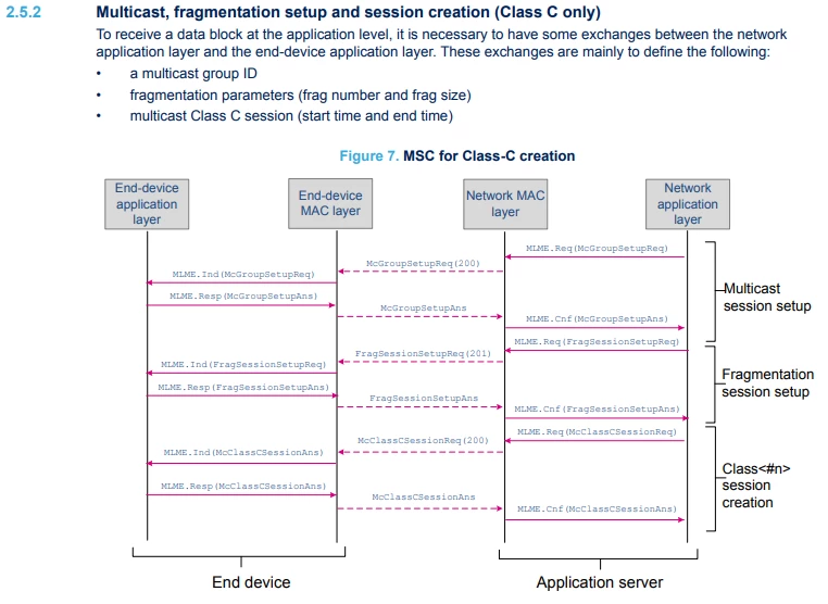

For more information, you can refer to this Application Note : AN5554 LoRaWAN® firmware update over the air with STM32CubeWL: https://www.st.com/resource/en/application_note/an5554-lorawan-firmware-update-over-the-air-with-stm32cubewl-stmicroelectronics.pdf
Section 2.4.4
0693W00000JPucRQAT.pngSection 2.5.2
0693W00000JPucqQAD.png And section 5.1, concerning the package :
