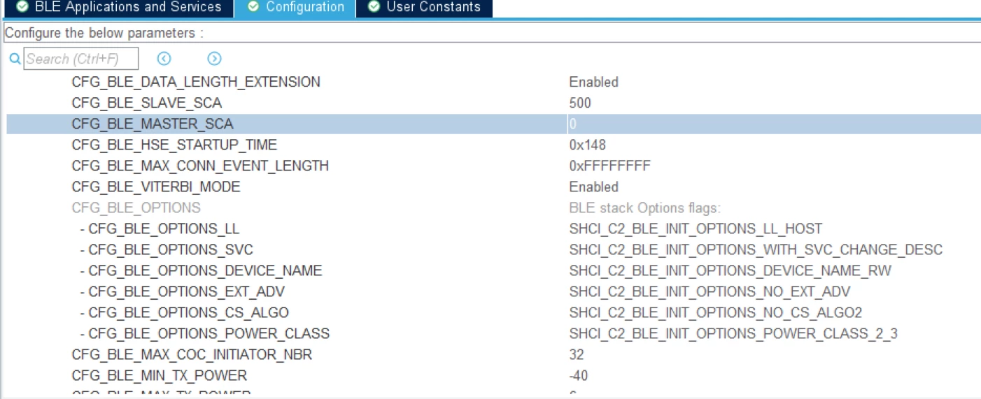

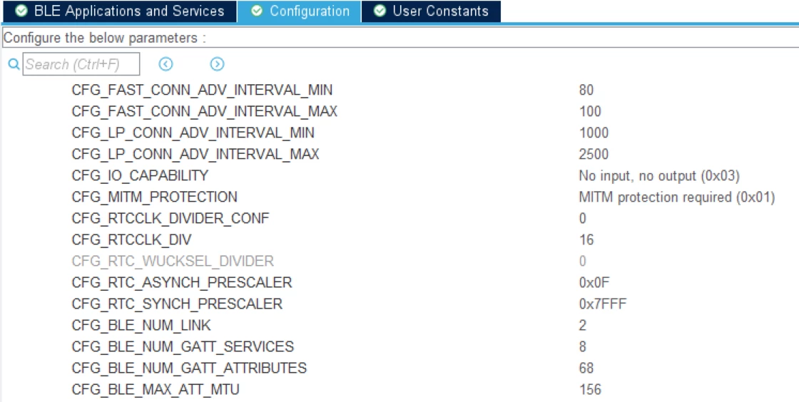

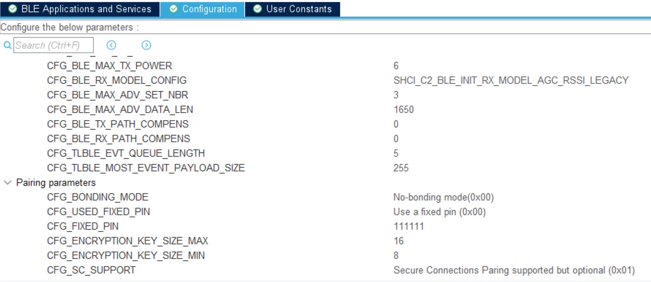

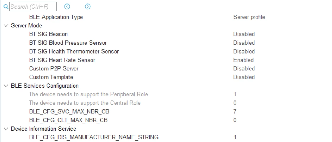

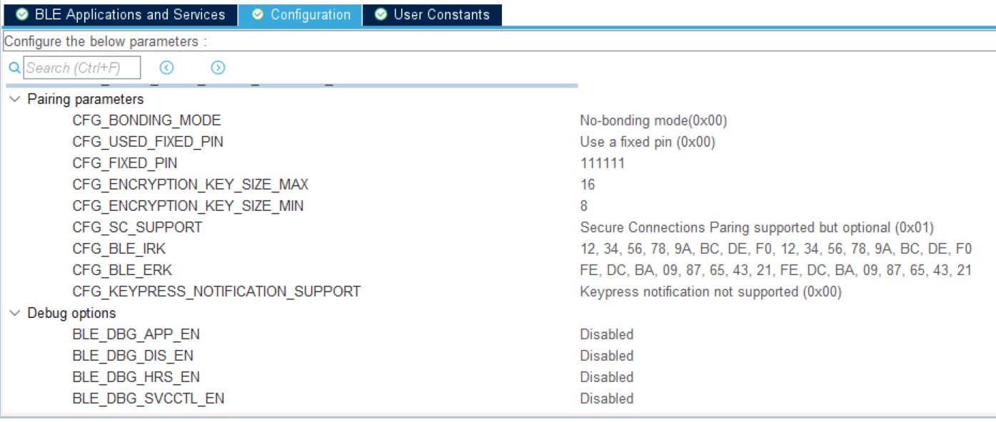

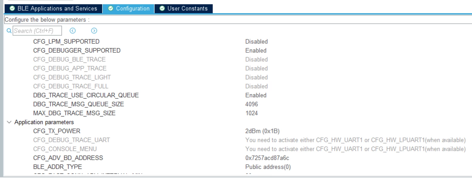

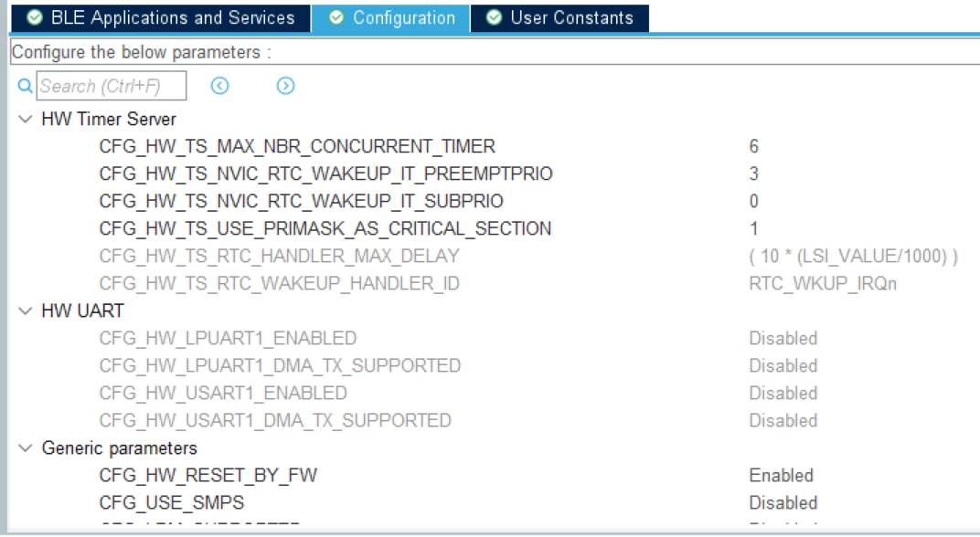

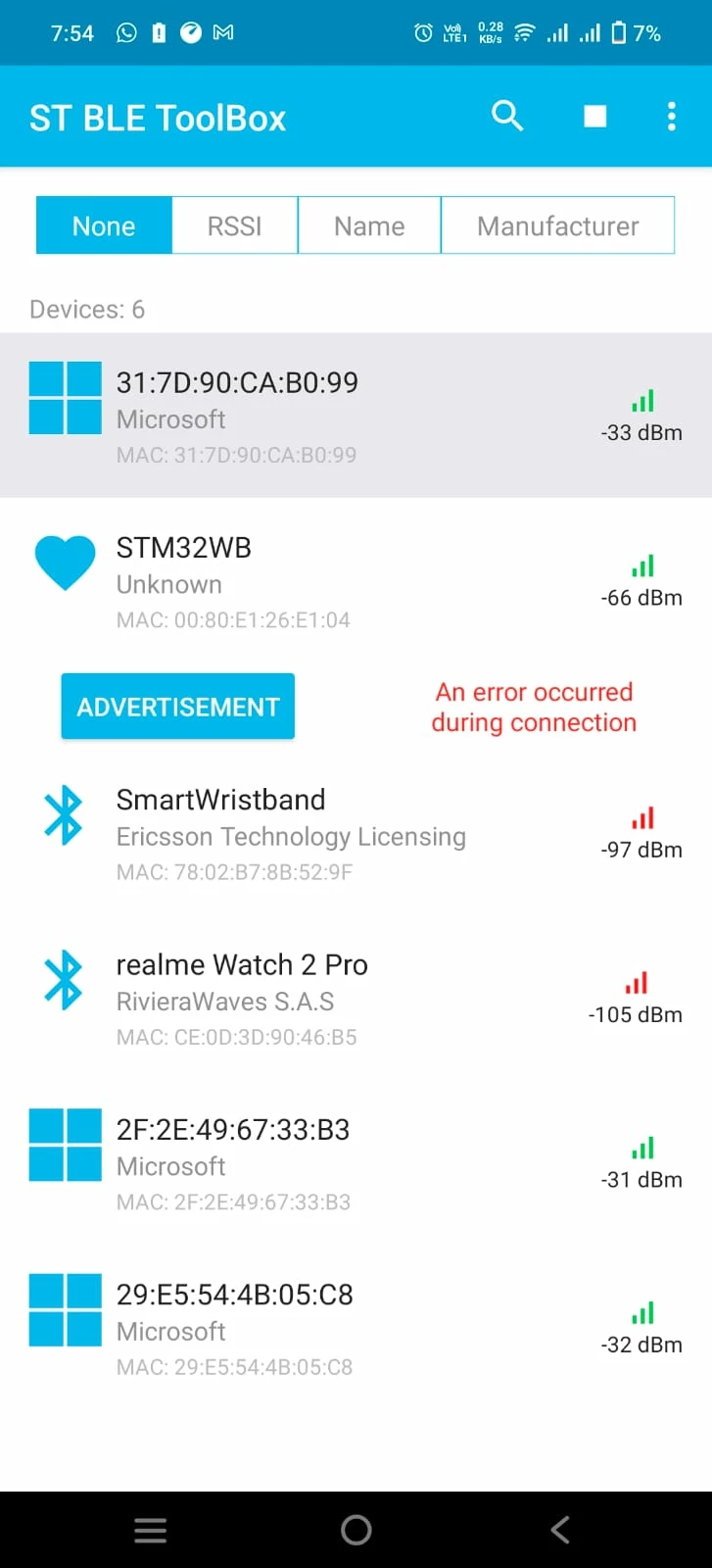

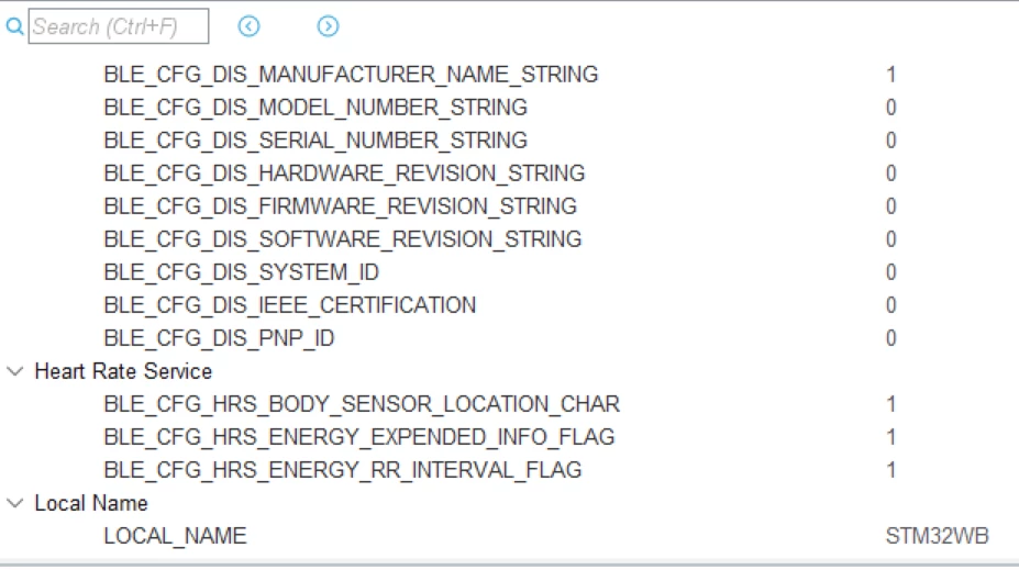

Case 2: Then after I tried to develop a project on CubeMX from scratch by selecting STM32WB55RGV6 chip (Not Nucleo board). I just made bare minimum settings with HeartRate sensor service just to see if it runs or not.
After downloading and running, I can see my device in ST BLE Toolbox android app but when I try to connect it with board, it doesn't get connected and gives an error like "An error occurred during connection".
I have attached few screenshots of the case 2 and I tried almost everything. what is wrong in case 1 as well as in case 2 ?

Can you give the version of CubeMX and STM32CubeWB package you are using ?
Ensure you have the following configuration for CFG_BLE_LSE_SOURCE define in app_conf.h file:
 #define CFG_BLE_LSE_SOURCE (SHCI_C2_BLE_INIT_CFG_BLE_LSE_CALIB | SHCI_C2_BLE_INIT_CFG_BLE_LSE_OTHER_DEV)

Thank you so much @Remy ISSALYS​  this really solved the issue. I forgot to enable calibration for the clock...
