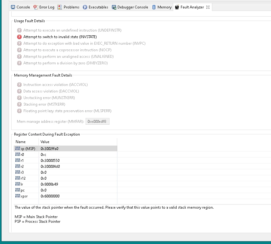

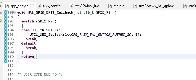

HardFault in the workshop on blue thooght with 03-STM32W-WS__How_to_add_BLE_functionality_V2.2. I can turn on and off the blue led. When I press button 1, the cortexM4 goes well in the interrupt routine: void HAL_GPIO_EXTI_Callback.
0693W000007DbYOQA0.png0693W000007DbbrQAC.png After the Return instruction, the Cortex M goes into Hardflault.
I use the STM32CubeIder 1.5.1.. It uses sequencer.c. I attach two screen prints:
The:void HAL_GPIO_EXTI_Callback, where there is a breakpoint
and that of the fault analyzer:
