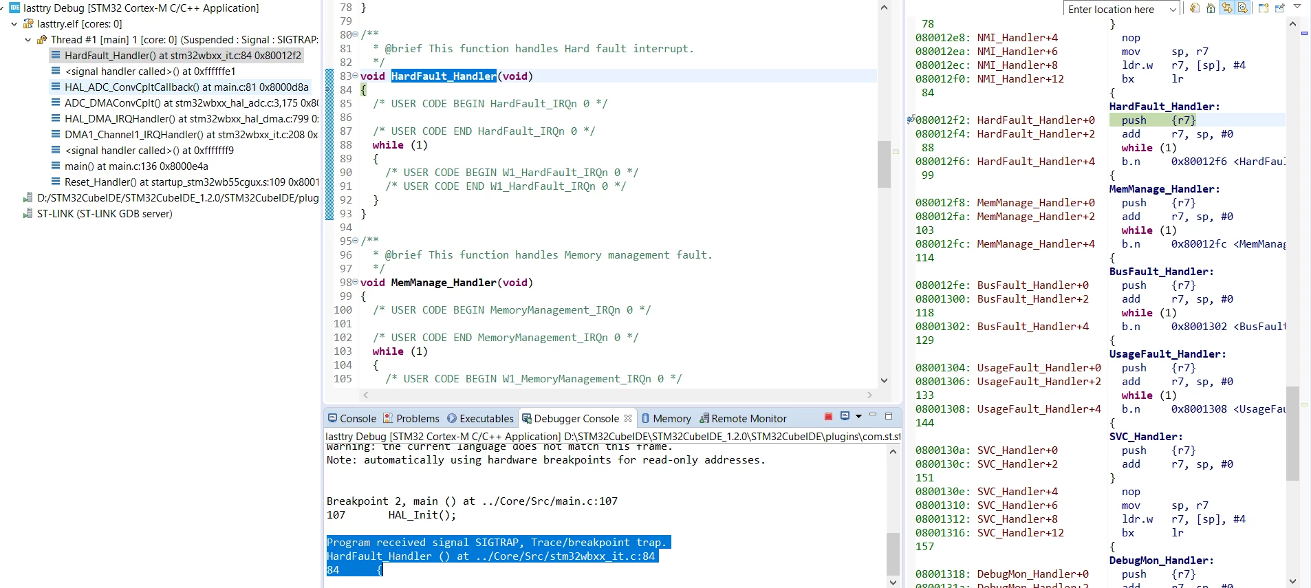

I am trying to read sensor data from an FSR402 using a STM32WB55CG in DMA with a temperature sensor as well.
For now I am mostly focusing on the FSR to also make the conversion from voltage to newtons.
After implementing the code for the conversion the programmed stopped working saying this:
Program received signal SIGTRAP, Trace/breakpoint trap.
HardFault_Handler () at ../Core/Src/stm32wbxx_it.c:84
84	{
I really don't know how to deal with all of this. I have already read something about the GDB server which I have never used as this would be my first time doing this type of project. However I notice that for the GDB I would need some connector that I do not have.
I will also attach a photo of my code where I am doing the conversion for the sensor.
You are already using it - look at the bottom line at your call stack window... ;)
Hard faults can also be debugged: http://www.keil.com/appnotes/files/apnt209.pdf
fsrResistance = ((voltageIN - ADC_BUFF[0])*resistor)/ADC_BUFF[0]; // Ohms
fsrConductance = 1000000/fsrResistance; //microOhms
Both of these lines can get into division by zero, which probably is your problem.

Thanks for the answer! I managed to solve the problem after all!

I guess he simply checks if the divider is zero.
if (fsrResidance) ...
