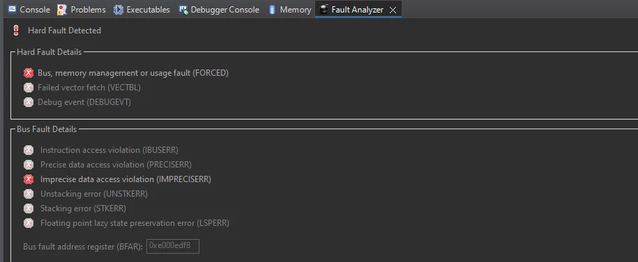

Hi there,
I am receiving a hardfault when erasing pages of flash, seemingly randomly. I can recreate the issue somewhat consistently if I rapidly erase flash pages. I have followed the example project from the STM32WB firmware package (erase flash example).

Specifically I will hardfault when trying to perform HAL_FLASH_Lock( ) when HAL_FLASHEx_Erase fails (line 23 in the code snippet above)
if (HAL_FLASHEx_Erase(&EraseInitStruct, &page_error) != HAL_OK)
 HAL_FLASH_Lock();
 return FLASH_ERROR;

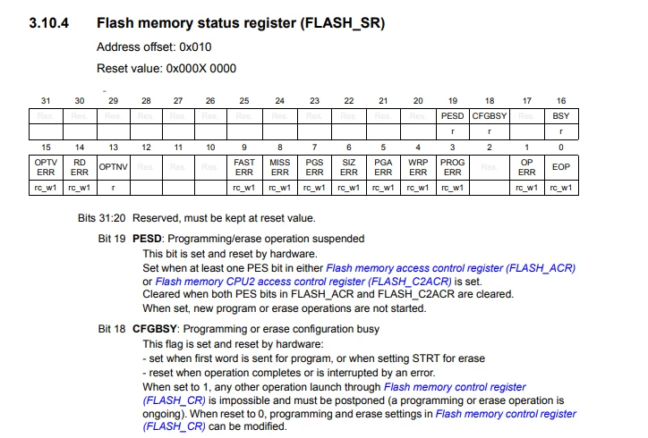

From the reference manual (RM0434 - Section 3.10.5 FLASH_CR) for the STM32WB I see that
"This register (FLASH_CR) must not be modified when CFGBSY in Flash memory status register
(FLASH_SR) is set. This would result in... a bus error, if CFGBSY is set due to a double-word programming sequence and the write to FLASH_CR is performed after the first word is sent for programming and before
the second."
The hardfault I receive is a bus error

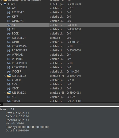

Further, when I inspect the CFGBSY bit in the FLASH_SR register I find that it is set
So I figure the fault occurs because the program tries to modify the FLASH_CR register when the CFGBSY bit is set in the HAL_FLASH_Lock( ) function

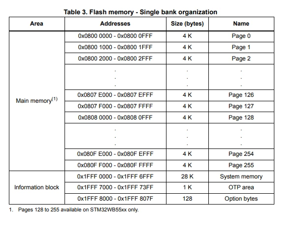

The specific pages of flash that I am modifying (erasing) are 167 - 170. According to the memory map for the STM32WB55 this is okay
