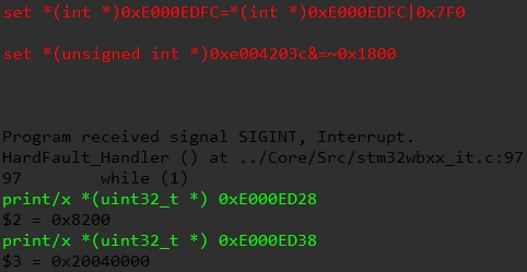

CFSR is 0x8200 (PRECISERR, BFARVALID)
BFAR is 0x20040000
However, I am stuck at trying to display the stack frame. All of the "svd" commands to debug further along that article are unknown to the "Debugger Console" tab in the STM32CubeIDE, and the "p/a *frame" command says there's no symbol "frame" in current context.

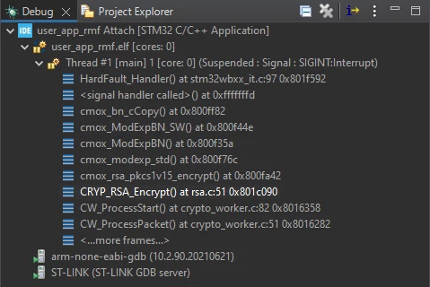

The stack trace indicates it's a problem from within the X_CUBE_CRYPTOLIB, when calling in "cmox_rsa_pkcs1v15_encrypt", the exception occurs in cmox_bn_cCopy. This method has been called thousands of times and never failed, so I don't know what's wrong.

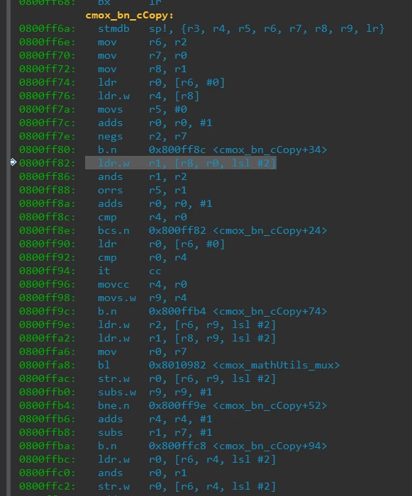

_legacyfs_online_stmicro_images_0693W00000dK1RyQAK.pngThe best I could do is inspect my code and make sure that all variables to "cmox_rsa_pkcs1v15_encrypt" are set properly, which they are. Since I don't have the symbols for the X_CUBE_CRYPTOLIB, I could only view the disassembly:
The MCU is still in this state, but as I said, this error occurred once now after using that part of the code thousands of times, so I really don't want to reset the MCU unless I know nothing more needs to be looked at. If I can extract more info and you can tell me which commands to run in order to get them, I'll be happy to help.
