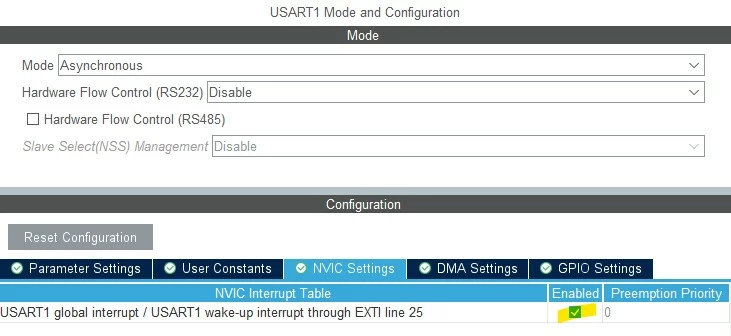

The code of HAL_UARTEx_ReceiveToIdle_DMA() will enable the IDLEIE bit, so enable the IDLE interrupt source inside the UART instance. Now in order to be genrated and processed the UART IRQ at NVIC side should also be enabled.
If you generate your code using STM32CubeMx tool, please make sure you do it in your UART configuration panel. (See below pic).
0693W00000HrgGPQAZ.jpgIf not, IRQ could be enabled in MSP_Init functions (as HAL_UART_MspInit) by below code :
 /* USART1 interrupt Init */
 HAL_NVIC_SetPriority(USART1_IRQn, 0, 0);
 HAL_NVIC_EnableIRQ(USART1_IRQn);

Principal
Jan 14, 2022 12:24 PM UTC
ding ding ding,
i was not using the uart in IT mode so i didint enabled the uart1 global interrupt at all.
Now it detects the IDLE state!
