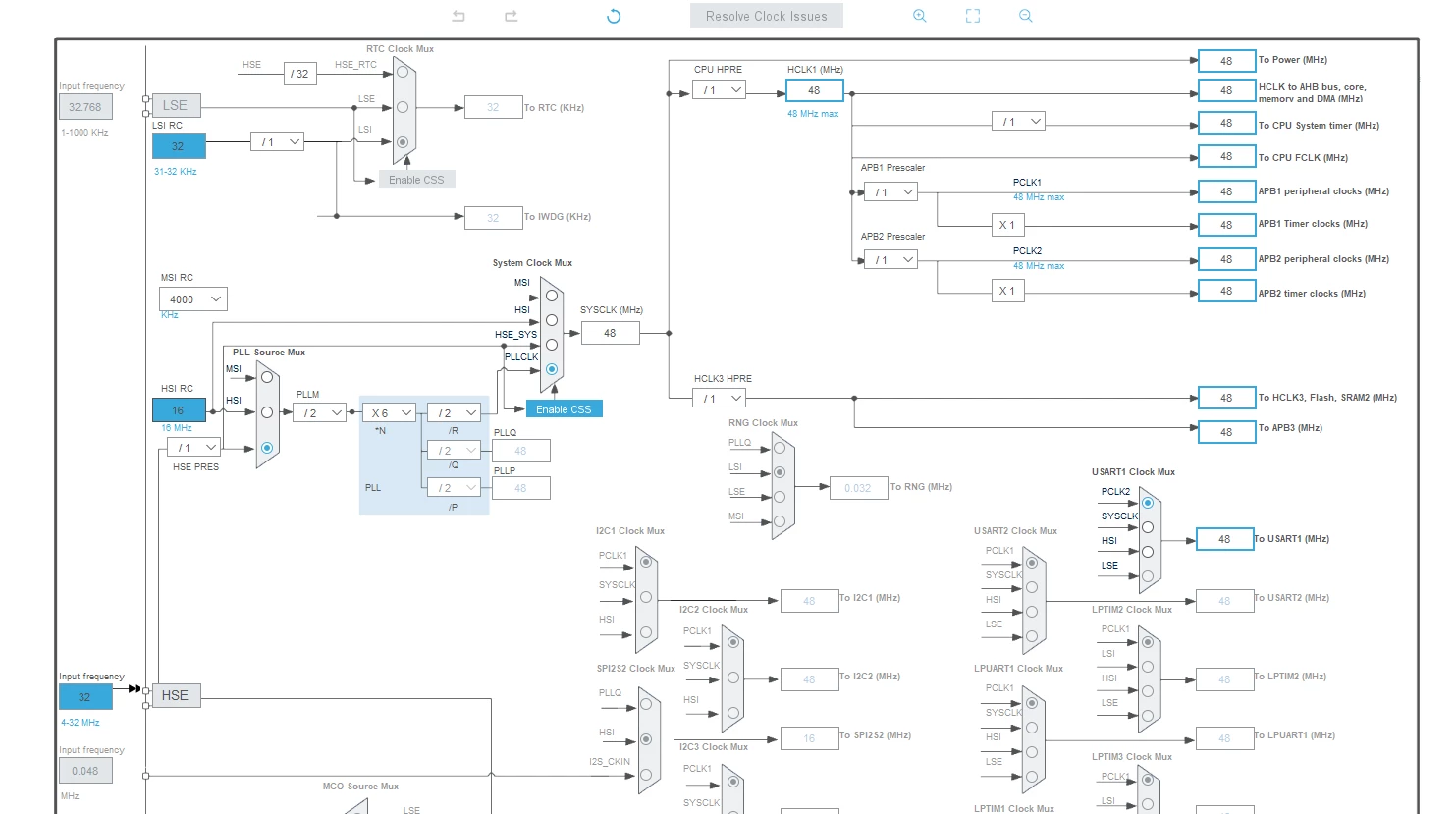

im currently working on a project for universtiy and im quite new to stm32.
I hava a sensor on my board that coummuicates via UART, were it dumps its data once per second. My problem is that the first HAL_UART_RECEIVE works as intended, but afterwards it always instantly times out, seemingly even before the set timout is over.
My MCU is a STM32WL55
My code is:

My clock tree:0693W00000SvFyWQAV.png
Any help is greatly appreciated.

Dear @D.Heink​
You could check the ISR of UART instance when you execute the 2nd reception (the failing one). Maybe some errors are already present in register, preventing the reception to be properly handled. I'm thinking about the Overrun flag (indicating that some data where received but not read on time from RDR). This could happen if additional data have been received after 1st reception is complete. When this flag is set (some data have been lost), but reception is frozen under the error is cleared.
If this happens in your case, you could clear the flag by resetting flag in ICR prior restarting 2nd reception, for instance using the dedicated macro :
__HAL_UART_CLEAR_FLAG(__HANDLE__, __FLAG__) with UART_CLEAR_OREF as flag.
Hope this could help.

Sep 13, 2022 2:54 PM UTC
Thank you very much. That fixed it right away.
