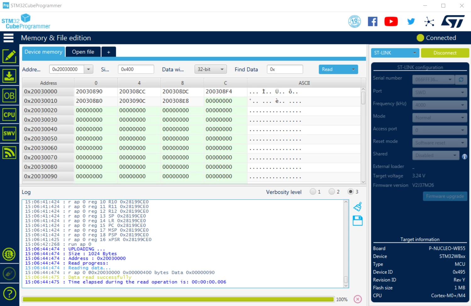

I am working on a project using the STM32WB55xx series. I'm trying to read the Device Information Table (AN5185 Section 6.6.1, pg 17) using a bash script and the STM32 Programmer CLI.
According to the documentation (AN5185 Section 1.2 page 3) I should be reading the IPCCDBA option byte to get the device info table address at the start of SRAM2a. The IPCCDBA value is 0x0, so the device info table address should be located at address 0x20030000. If I try to use the CLI to read at address 0x20030000, I get all zeroes in response.

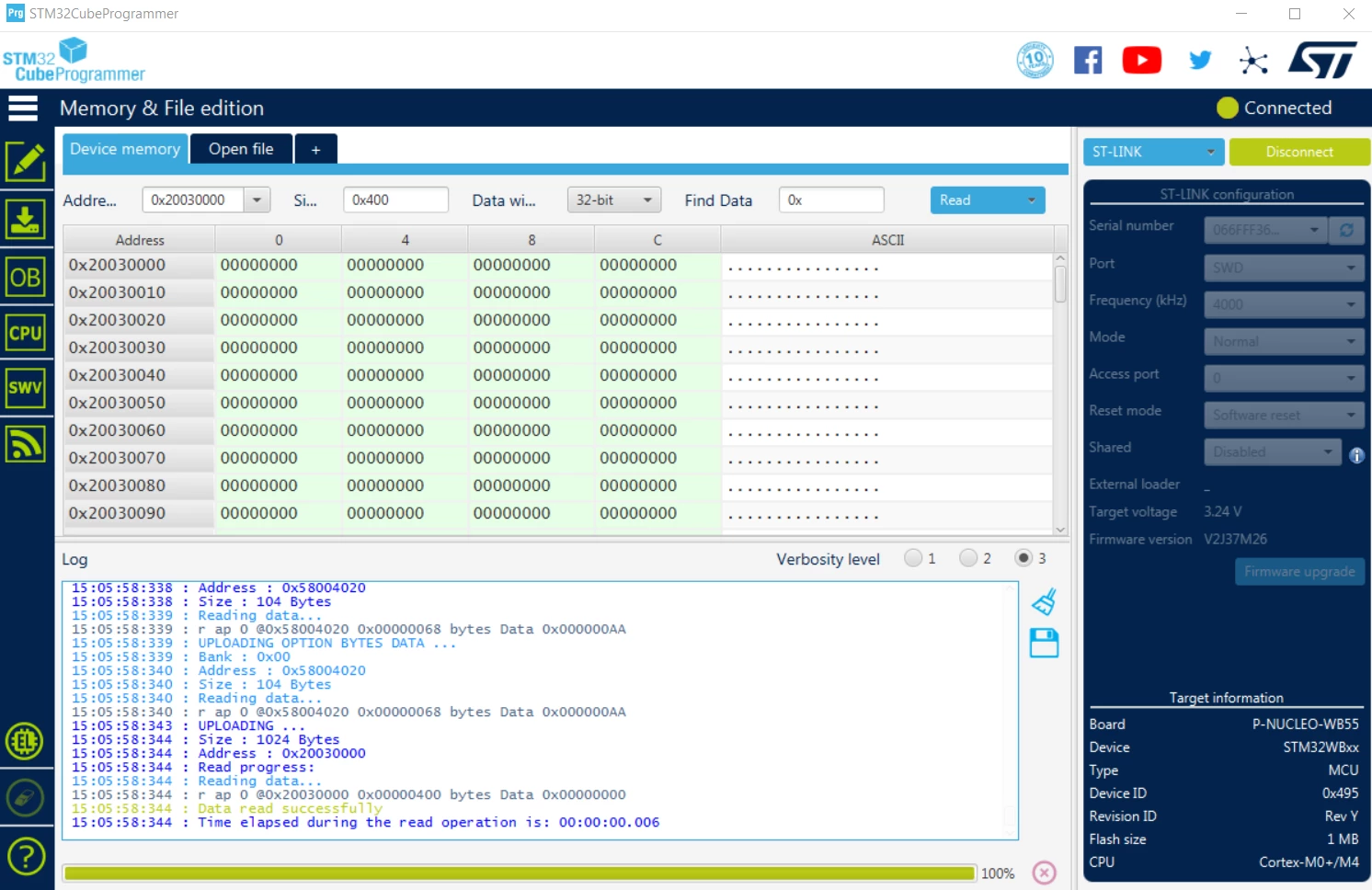

If I read the same address using the STM32 Programmer GUI, at first I get the same thing:
0693W000008GUVXQA4.pngHowever, if I switch to the CPU tab in the GUI and hit 'Run' first, I can check address 0x20030000 and I find a value of 20030890:

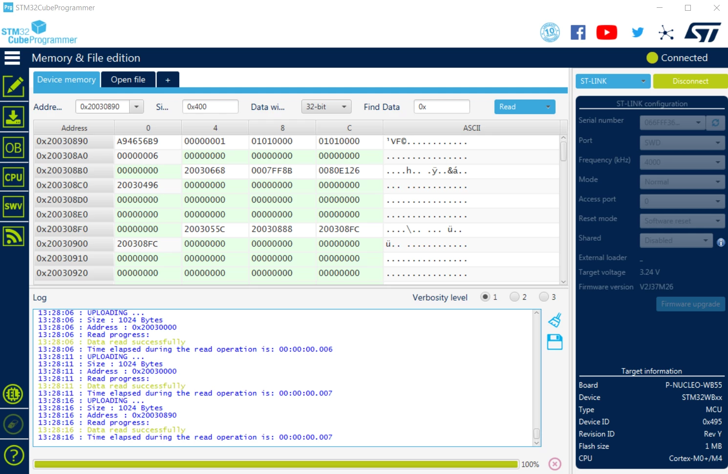

Then, I can read address 0x20030890, and I find the device info table, including the 'table valid' bytes 0xA94656B9:
Success! It seems that hitting the Run button makes all the difference for the GUI.
So now going back to the CLI, it appears that the analogous command for the Run button in the GUI is the '-run' flag in the CLI. Yet, even when I add in the '-run' flag to my command, I still do not get the 0x20030890 address showing up at 0x20030000. Only zeroes.
I suspect that there may be some syntax error or option I'm missing from my CLI command structure. What do I need to do to get the CLI to return the same data as the GUI?
