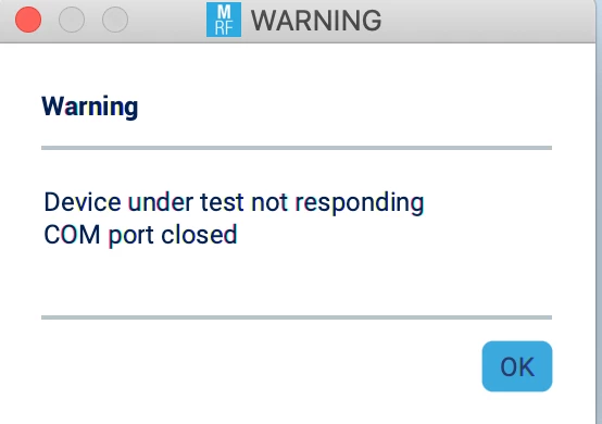

Getting a warning that - Device under test not responding COM port closed - when trying to connect the STM32CubeMonitor-RF to the WB55 Nucleo or Dongle.
Using either the default program or programming the BLE_TransparentMode default hex file results in this error. I have both a windows 10 and macOS 10.14.4 machine that I get this result. The VCOM port doesn't seem to be the issue as I can program and see the units. Any help would be much appreciated!

This error usually means that tool has no answer from device.  In this case the log will look like this :
The tool has tried to contact the target, but there was no answer after few seconds.
There could be various causes for this :
  • Not using the Transparent Mode. The tool rely on transparent mode software to communicate with the STM32WB. On Nucleo and USB Dongle kit, the default program is not  transparent mode. Transparent Mode must be used.
  • opening the wrong com port : It is good to check in the device manager if the virtual com port is visible with the same number. (The tool shows all serial ports of the computer).
  • the transparent mode is not running properly. If the software is crashed on the target, the tool have no answer
  • the serial path is not correct : Nucleo should be connected by the ST-Link port and jumpers TX RX should be present.
  • For USB dongle the Transparent mode has been used instead of BLE_TransparentModeVCP
  • For user pcb, the uart used is not the same as nucleo, or not properly configured.
  • For USB dongle, the VCP driver is not installed (it is not the same as the ST-Link driver)
There is an overview of the connection in the user manual (UM2288, chapter 2)  You may find some clues in this doc, and it should help to understand the connection path.

@MPiot.1​ I tested on my USB Dongle and it works properly. I did as I explained to you before. Open the device management and check if it's all okay with the ports. Check if the port that you are using is not opened in another program. Try to disconnect the port in device management and reconnect and check if all jumpers are in the correct places (you can see in the documentation how they should be put).

@Kolab​ Actually, I tried the Nucleo example. The binary is working just fine, I can connect through the COM Port. However, when I generate and compile the project, the compiled binary gives the same error as described.
