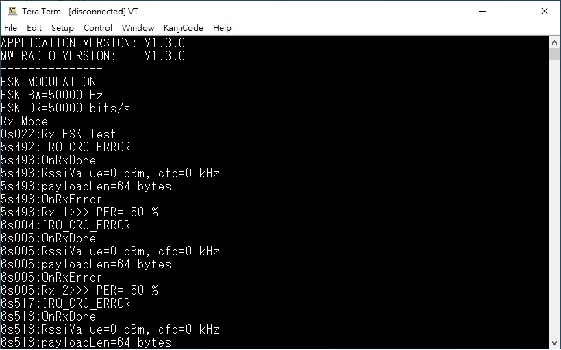

Hi all,
My application is showing below
Device(NUCLEO-WL55JC1 EVM) send data to Gateway --> wait 100msec --> enter receive to wait data from gateway. In my test, If data from gateway more then device. The device report CRC Error to application layer.
I reproduce similar problem with (sample code)
1. Import SubGHz_Phy_Per and build it as TX side
2. Use attachment as RX side
3. IF data data length less then 64. I will get IRQ_CRC_Error and OnRxDone at the same time
