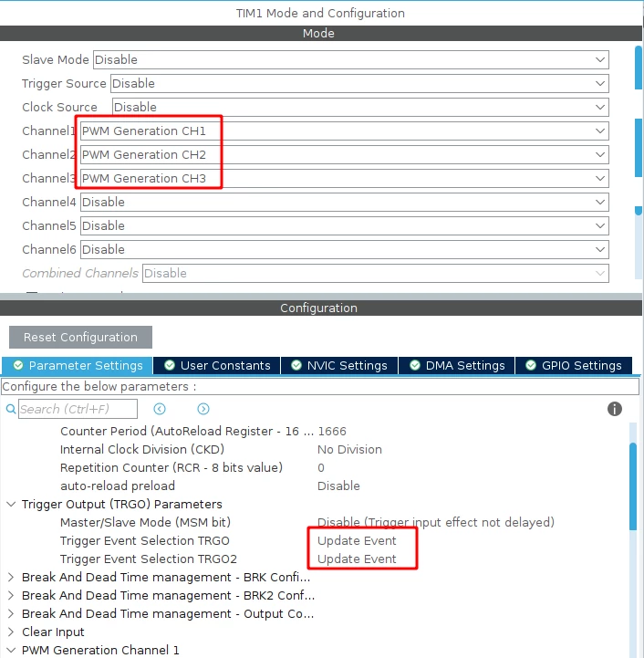

I'm working on generating two different trigger signals: one at 60Hz and another at 600Hz, using three PWM signals on three GPIO or timer channels. I attempted to use slave trigger mode for synchronization, but I'm encountering a phase shift in the PWM signals after two or three pulses.
Can you please guide me on the best possible way to achieve this task?

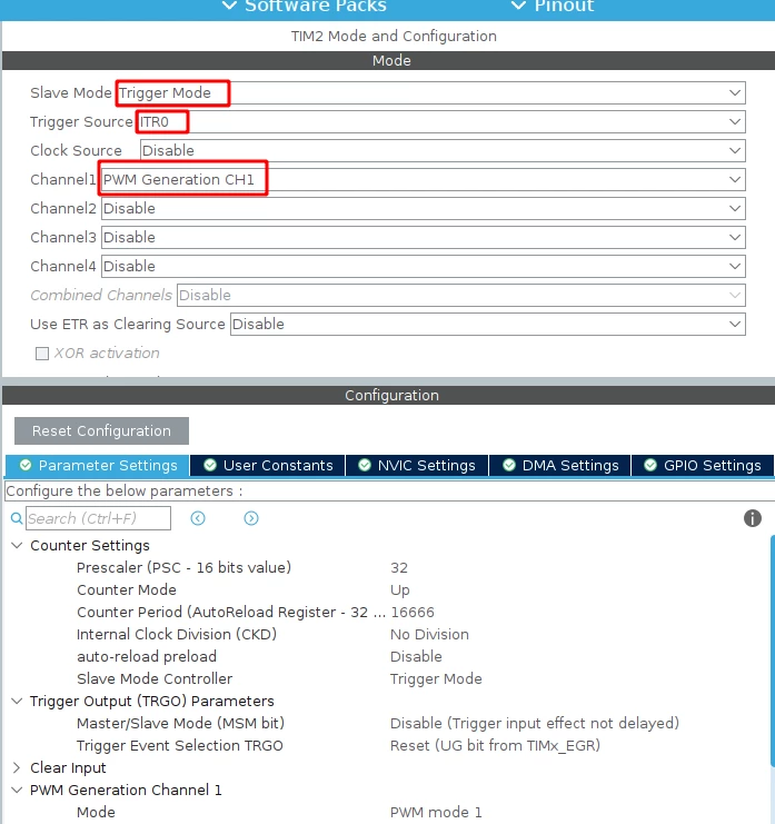

Hi @Sarra.S ,
Below are the timer configurations for slave trigger synchronization. I have also attached the IOC file for your review.
 /* USER CODE BEGIN 2 */
 HAL_TIM_Base_Start(&htim2);
 HAL_TIM_Base_Start(&htim1);
 HAL_TIM_PWM_Start(&htim2, TIM_CHANNEL_1);
 HAL_TIM_PWM_Start(&htim1, TIM_CHANNEL_1);
 HAL_TIM_PWM_Start(&htim1, TIM_CHANNEL_2);
 HAL_TIM_PWM_Start(&htim1, TIM_CHANNEL_3);
 /* USER CODE END 2 */
Timer1 configuration
Timer 2 configuration

Trigger mode in Slave-mode controller does nothing else just sets TIMx_CR1.CEN.
In other words, the key is that slave must have TIMx_CR1.CEN=0 if you want to trigger it, otherwise the trigger is ignored.
I don't use Cube and don't know and don't want to know, if the way how you are clicking it in CubeMX and subsequently use in your program, fulfills this requirement or not. But if not, that's the reason why it does not work as you expect.
