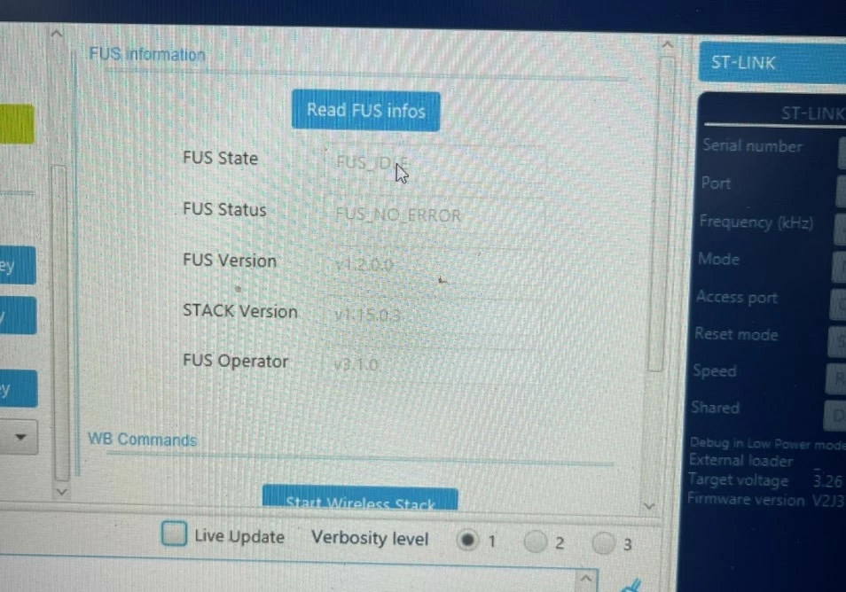

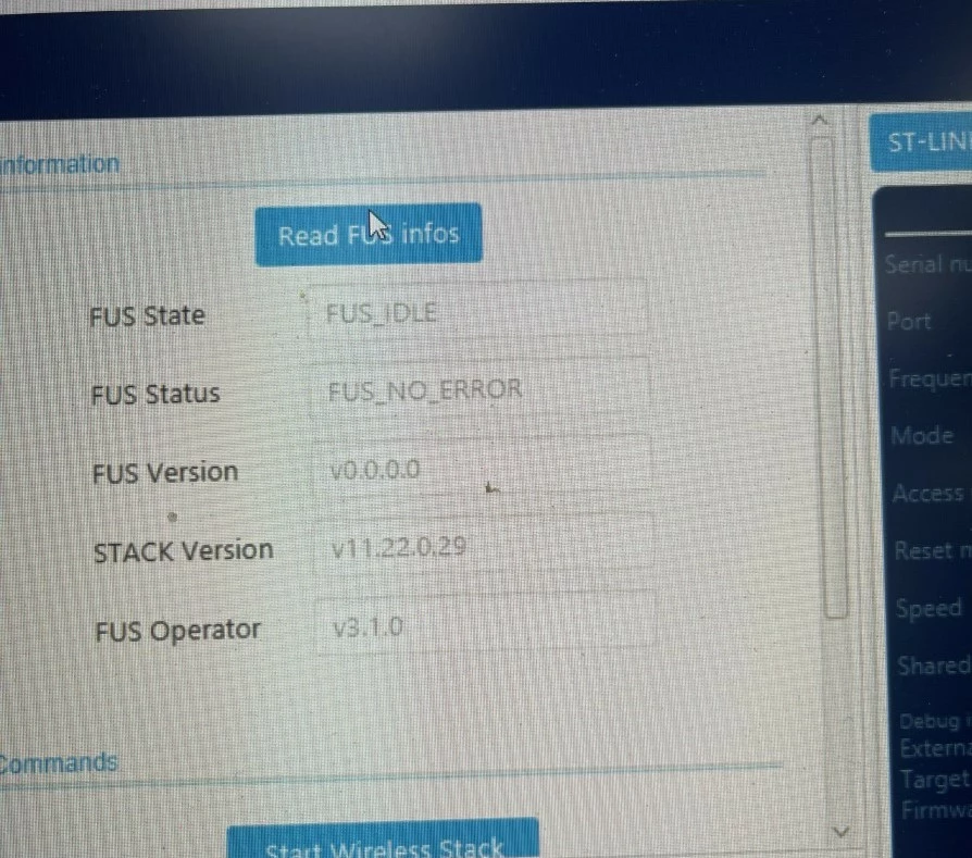

On my second board which has a following Firmware (Stack Version V11.22.0.29). when I tested p2pserver and heartrate examples. It worked all fine. I could see the connection on BLE sensor App. The issue was when I tried to make the custom connection instead of p2p (as done in this video " STM32WB Getting Started Series: Part 12b, Lab. Receiving data from the phone " it didn't work.
I tried to update it to latest firmware (stack version V.15.0.3) , now the examples doesn't work as well. Can you guys guide me what the issue is?

Did you flash the stm32wb5x_BLE_Stack_full_fw.bin binary on the Wireless Coprocessor? On the second picture, you should have the same information as on the first picture.

That's exactly what I flash, the second picture is before I flash the stm32wb5x_BLE_Stack_full_fw.bin binary on the Coprocessor Wireless Binaries. Before flash (referring to fig 2), when I tried the examples from the STM32CubeWB Package, it worked fine. I was able to see the connection through the BLE Sensor App.
After the flash (referring to figure 1), when I tried the example again, there was no connection on the App.
Can you please tell what am I doing wrong?

On STM32CubeProgrammer, when you flash the stm32wb5x_BLE_Stack_full_fw.bin binary on the Wireless Coprocessor, ensure the option "Start stack after upgrade" is checked.
