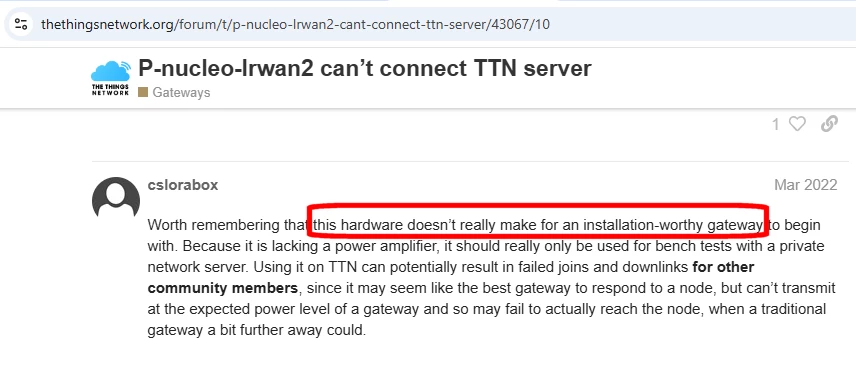

Andrew Neil
October 28, 2024
Note that the  P-NUCLEO-LRWAN2 gateway is not suitable for public deployment:
https://www.thethingsnetwork.org/forum/t/p-nucleo-lrwan2-cant-connect-ttn-server/43067/11
