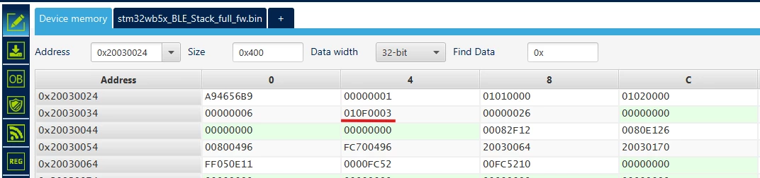

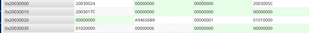

July 16, 2026
Hi BertrandM,
Thank you for posting in the ST Community.
So far, I have not been able to reproduce the issue you described.
Here my setup:
  • P-Nucleo-WB55 (hardware: MB1355C-02, STM32WB55RGV6U revision Y)
  • FUS v1.2.0.0
  • STM32CubeProgrammer v2.22.0
  • Project STM32WB-FUS-Command-Line-Interface
  • STM32CubeIDE v2.2.0
  • The project is a bit old and a previous version of GNU is needed (I'm using v10.3)
  • I have tested update for stm32wb5x_BLE_Stack_full_fw.bin (from STM32CubeWB v1.13.1 / v1.15.0 / 1.16.0 / v1.17.0)
  • the BLE_Full wireless stack image is loaded at optimal address 0x080CE000
With this simple project/setup, I'm able to get a correct Device Info Table (with consistent version of Wireless stack).
Here the screenshot of the Device Info Table:
Here few questions/recommendations:
1) As mentioned by OliM, are you calling FUS_FwUpgrade command with 0 arguments?
SHCI_C2_FUS_FwUpgrade(0,0);
2) Don’t hesitate to have a look on the project I’m using:
https://github.com/stm32-hotspot/STM32WB-FUS-Command-Line-Interface
Otherwise, please consider to share with me your code (even partially, just the Wireless Stack update part).
3) Are you observing similar results when updating the stack directly with STM32CubeProgrammer (embedded bootloader or SWD)?
4) In your case, is BLE operational even with invalid Device Info Table?
5) Did you try to move to latest (and recommended) version of FUS v2.2.0?
Best Regards,
Alan
