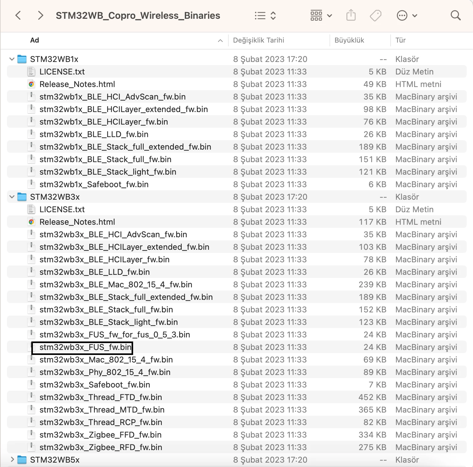

Thanks for reply, but there is a problem about starting FUS or reading FUS version. It cannot start because FUS is corrupted while we do something. Its version seems 0.0.0. So we want to flash FUS binary again to recover it.
In STM32WB3x or STM32WB5x series folder, there are "stm32wb3x_FUS_fw.bin" and "stm32wb5x_FUS_fw.bin" files. But there is no "stm32wb1x_FUS_fw.bin" in STM32WB1x series folder.
Can you share this binary with us?

There is a folder screenshot about FUS_fw.bin.

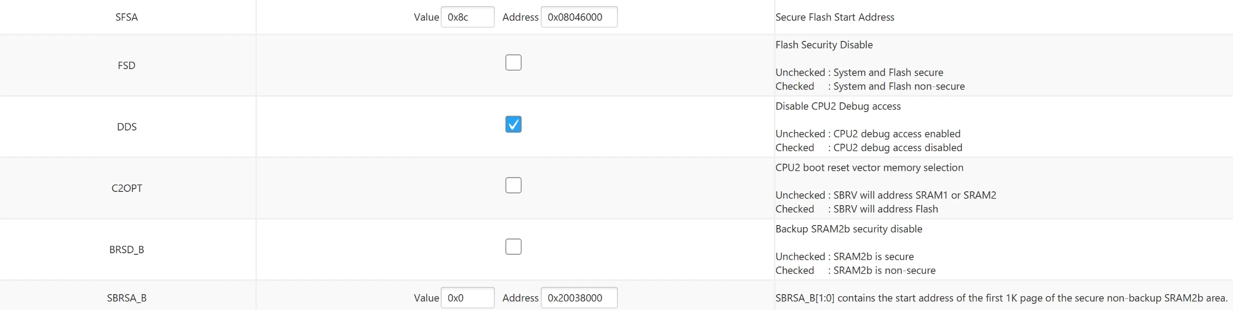

According to SBRV option bytes value, the FUS is not running, you should start the FUS before reading the version. Can you add a screenshot of ESE option bytes?
Best Regards
batuars
batuarsAuthor
May 22, 2023 12:24 PM UTC
ESE is checked.

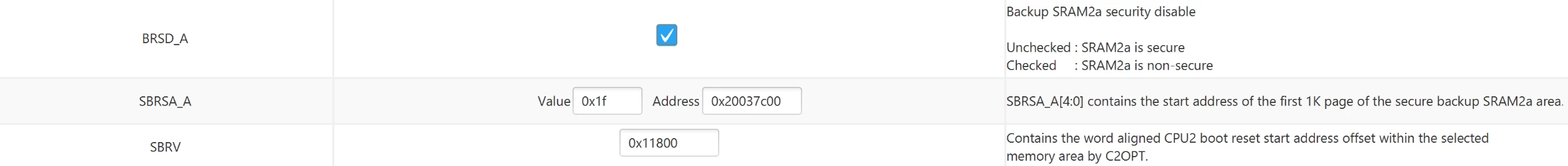

When I press Start FUS on STM32CubeProgrammer, it shows me
And after I press Read FUS infos, it shows me following info, and SBRV is 0x11800.

In my previous I made a mistake, SBRV at 0x11800 indicate that the FUS is running. Unfortunately, I can't share a FUS binary file. Which version of STM32CubeProgrammer tool are you using? And which interface are you using to connect board?
