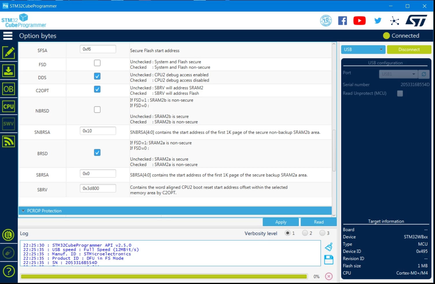

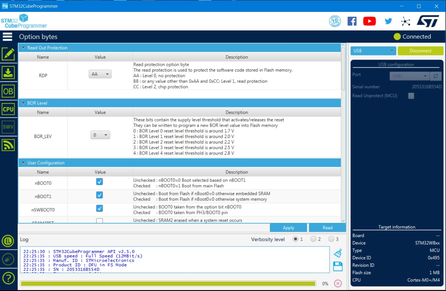

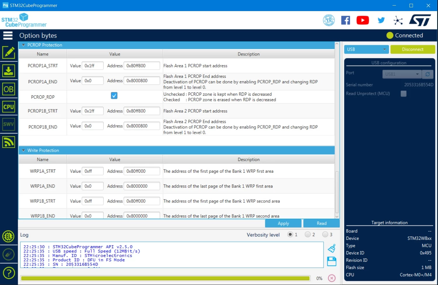

Parmin Nayani
Oct 16, 2020 5:06 PM UTC
Hi Remi QUINTIN,
Here are the screenshots.

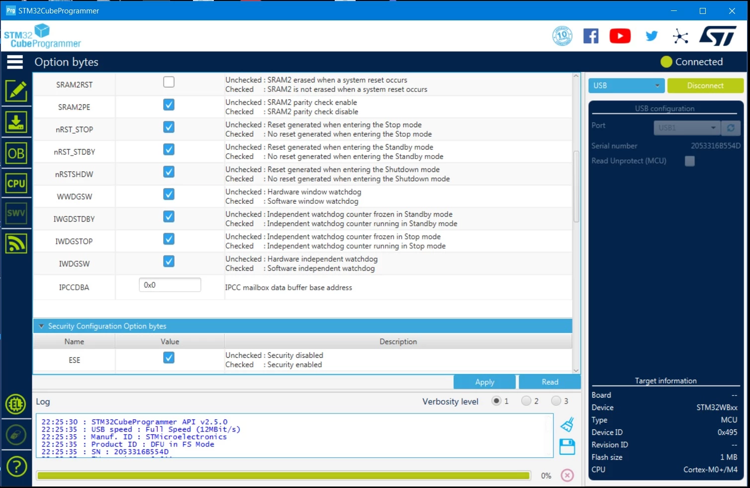

Parmin Nayani
Oct 16, 2020 5:07 PM UTC
Not able to upload many files simultaneously
Parmin Nayani
Oct 16, 2020 5:08 PM UTC
One more
Parmin Nayani
Oct 16, 2020 5:09 PM UTC
Last one
Remi QUINTIN
Oct 16, 2020 5:26 PM UTC
​OK. So according to the SFSA value (0xF6), your FUS version is still V0.5.3 which is the very first version of FUS.
You have to upgrade it to be able to program one of the RF stack of the latest CubeWB FW pacakage.
Please use the last CubeWB FW package v1.9.
Perform a mass erase of the flash memory. Dont worry , you will get an error when the tool tries to erase the FUS protected sectors (above SFSA location).  But in the end, the user part of the memory becomes clean.
Then perform a fwdelete. Here you may not need it as there is no RF stack on your chip curently.
Then program the stm32wb5x_FUS_fw_1_0_2.bin  binary (= FUS V1.0.2)
Then program the stm32wb5x_FUS_fw..bin binary (= FUS V1.1.0)
Then program the RF stack you want using the start address listed in the release notes.
Finnaly program your application at 0x08000000.
Normally it should work!!! anyhow cross the fingers, it may help :)

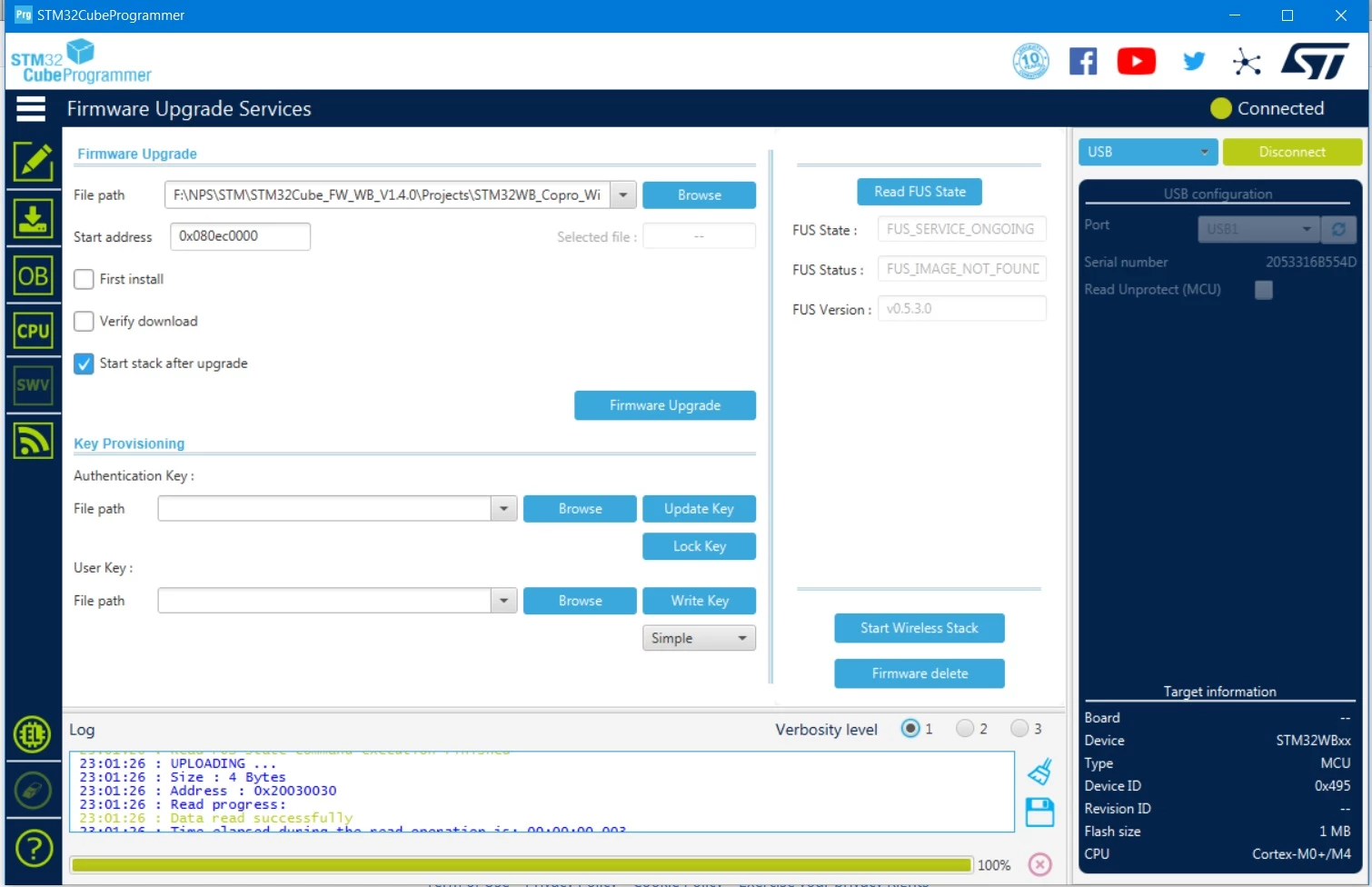

Parmin Nayani
Oct 16, 2020 5:33 PM UTC
Missed to post FUS readings. Here they are
Remi QUINTIN
Oct 16, 2020 5:50 PM UTC
​Yes! You can either select the sectors up to F6 not included or select a full chip erase. This will generate an error but it is in fact a warning indicating that not all sectors have been erased. but it is ok.

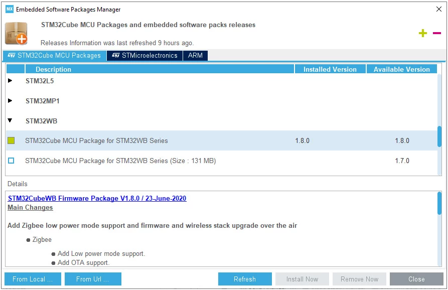

Mecanix
Oct 16, 2020 6:04 PM UTC
@Remi QUINTIN​
In STM32CubeIDE; can you remind us how and where to verify we are running the latest CubeWB FW package please. You mentioned that FW package v1.9 is out and I did not know that, neither wouldn't be able to tell if STM32CubeIDE is using the latest APIs from 1.9.
What is the ST guidance on remaining updated with the STM32WB? or is this something that is carried out automatically via background downloads from/by STM32CubeIDE?
Thanks
Mecanix
Oct 16, 2020 6:12 PM UTC
ok, I get it, I think. 1.9 released on the Github repo, however not yet supported within STM32CubeIDE. Is this correct?
ps. just found out how to manually check for package updates. Spoiled by the automatic updates of CubeIDE, I got lazy in checking I'm guessing ;)

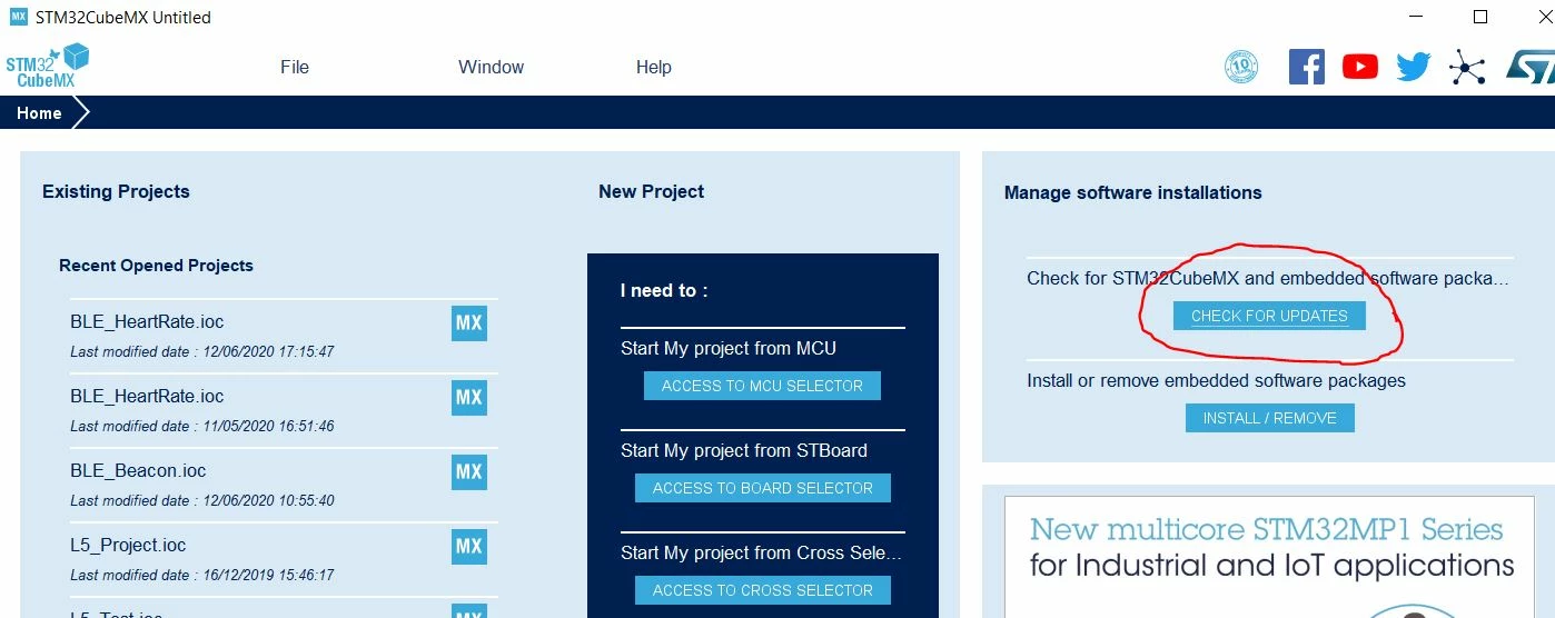

Remi QUINTIN
Oct 16, 2020 6:27 PM UTC
​CubeWB FW package V1.8 is for sure supported by CubeIDE. I need to check for V1.9
Remi QUINTIN
Oct 16, 2020 6:20 PM UTC
​The usual way to start a project is to use CubeMX tool. You can check for any CubeFW  package update each time you want to conf0693W000004K6kkQAC.jpgigure your project. (see picture below)
