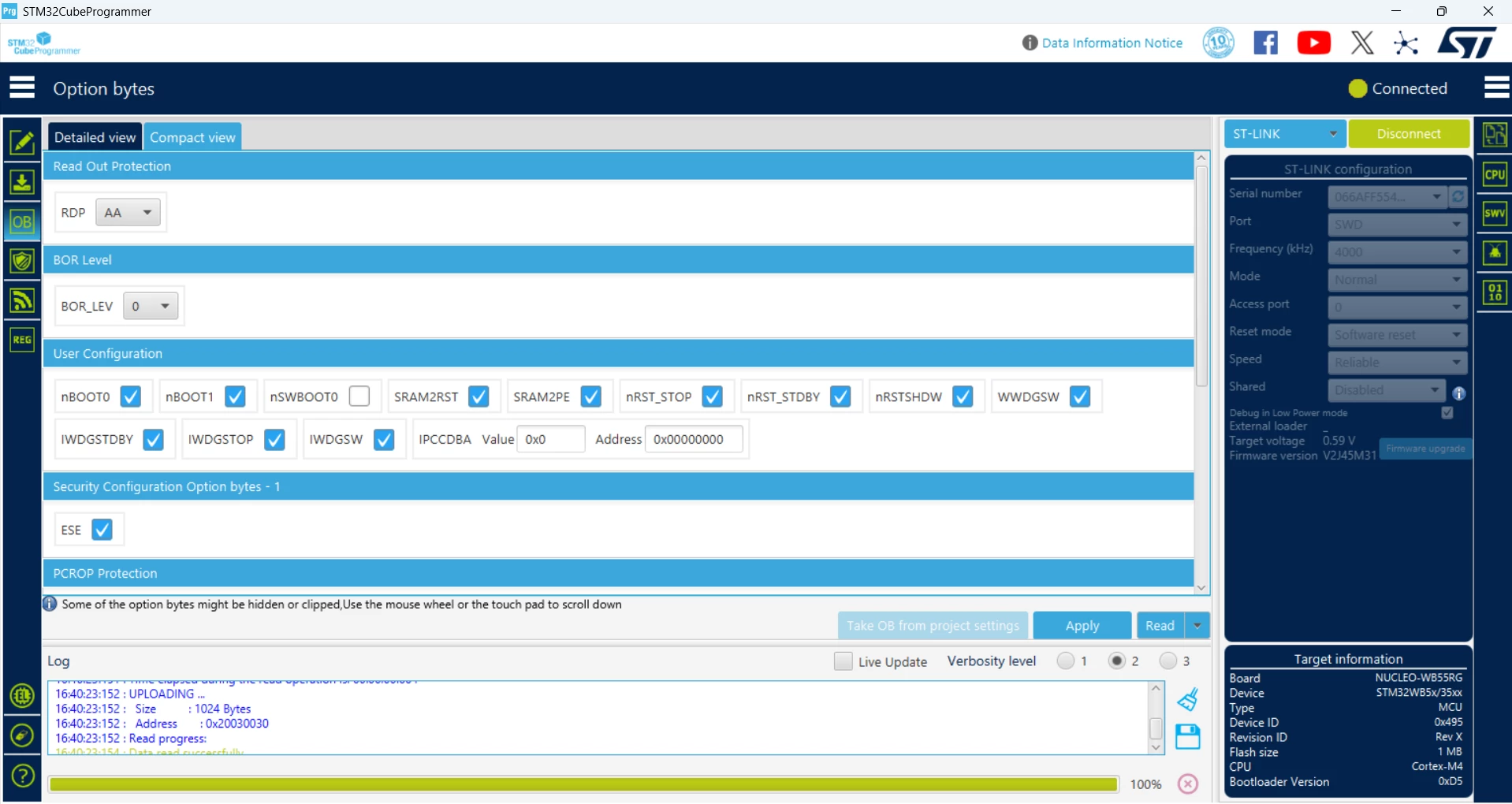

I'm working with a custom STM32WB55RG board which initially was working properly, reading documentation regarding failures and STM32WB Firmware Upgrade Service upgrade.
I tried to upgrade and follow the steps indicated, I also tried to follow several solutions that are in the forum but none of them succeeded to give me a solution.
I connect my card to the CubeProgrammer program.

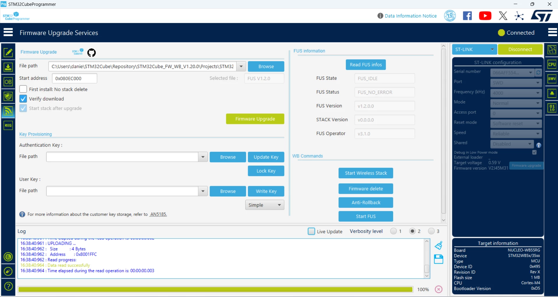

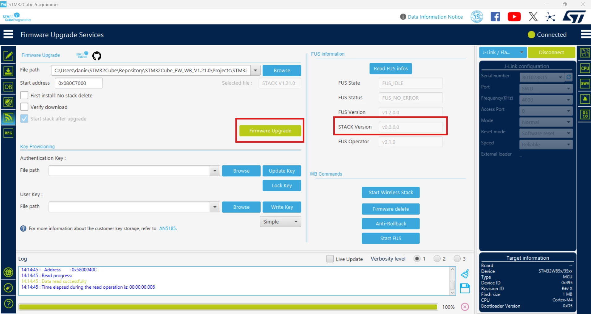

Firmware Upgrade Services Login

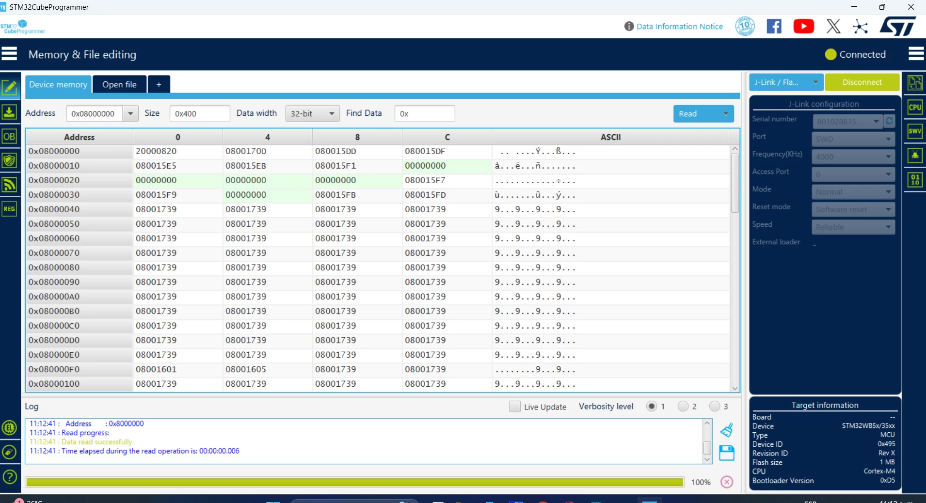

I verify in the memory address that the fus is found.
Pin configuration

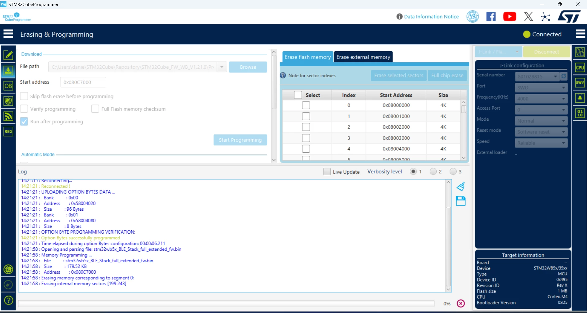

Now I am going to program the Wireless Stack but it fails to program.
LOG
16:47:20:713 : Opening and parsing file: stm32wb5x_BLE_Stack_full_extended_fw.bin
16:47:20:726 : Memory Programming ...
16:47:20:726 : File : stm32wb5x_BLE_Stack_full_extended_fw.bin
16:47:20:728 : Size : 184.18 KB
16:47:20:730 : Address : 0x080C5000

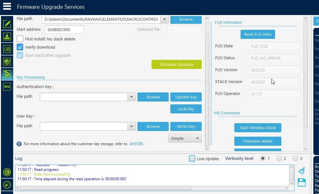

Another recurring error that I have is that the +M0 address is at 00000000, in one of the forums and solutions say that I program it at 00008000 in the memory address 0x5800040C.
I can program it but it gets deleted again.

Could you try using the stm32wb5x_BLE_Stack_full_extended_fw.bin from the last version of the STM32CubeWB (V1.21.0). on the address 0x080C7000 (using the STM32CubeProgrammer V2.18.0).
Best Regards.

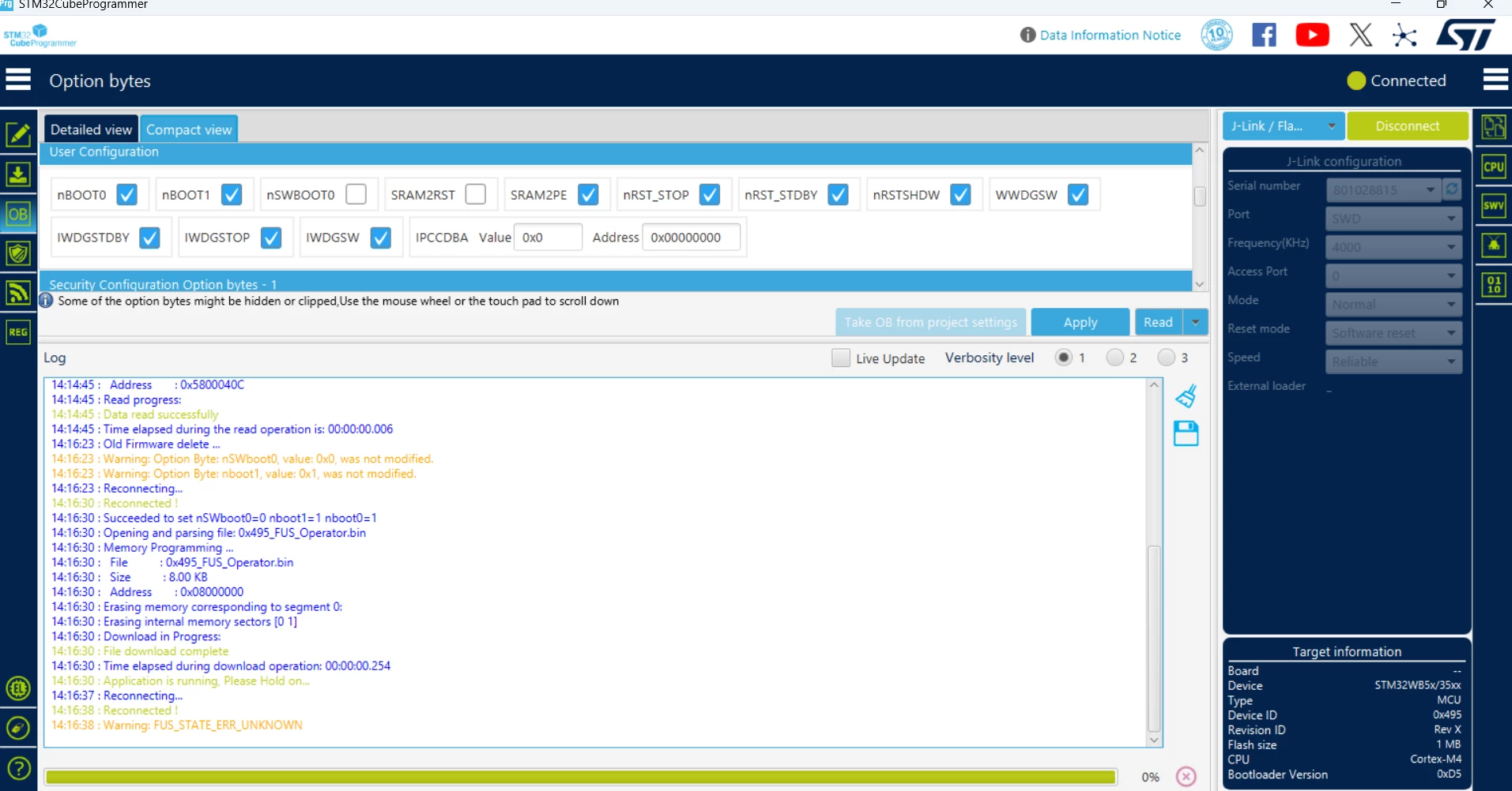

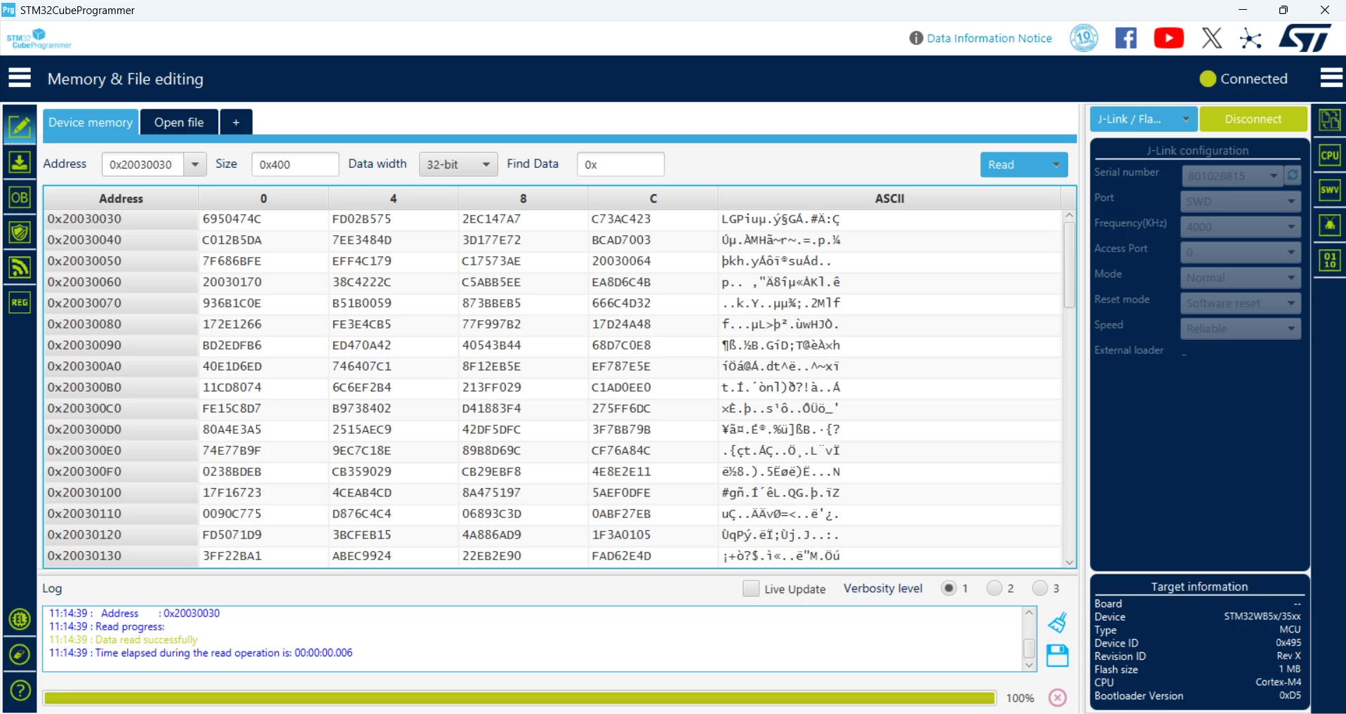

Hi, following your instructions Use STM32CubeProgrammer V2.18.0 and stm32wb5x_BLE_Stack_full_extended_fw.bin from V1.21.0.
Process used to program

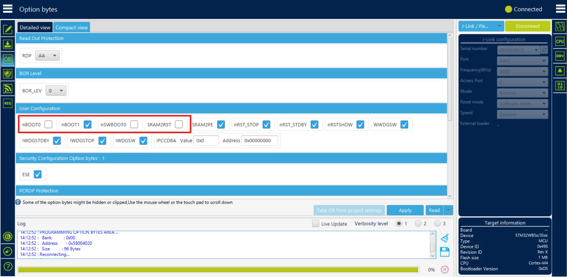

  1. PIN CONFIGURATION
2.programming

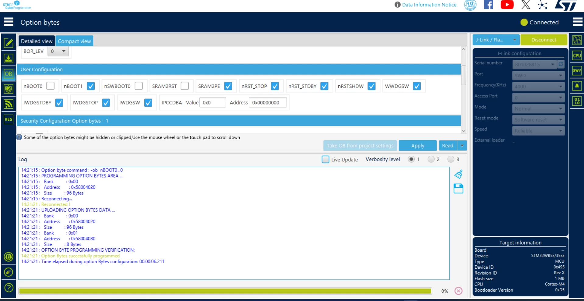

initially I try to program by firware upgrade but it changes the configuration of the nBOOT0 pins to check which causes it to send the program to 0x08000000.
14:14:45 : Time elapsed during the read operation is: 00:00:00.006
14:16:23 : Old Firmware delete ...
14:16:23 : Warning: Option Byte: nSWboot0, value: 0x0, was not modified.
14:16:23 : Warning: Option Byte: nboot1, value: 0x1, was not modified.
14:16:23 : Reconnecting...
14:16:30 : Reconnected !
14:16:30 : Succeeded to set nSWboot0=0 nboot1=1 nboot0=1
14:16:30 : Opening and parsing file: 0x495_FUS_Operator.bin
14:16:30 : Memory Programming ...
14:16:30 : File : 0x495_FUS_Operator.bin
14:16:30 : Size : 8.00 KB
14:16:30 : Address : 0x08000000
14:16:30 : Erasing memory corresponding to segment 0:
14:16:30 : Erasing internal memory sectors [0 1]
14:16:30 : Download in Progress:
14:16:30 : File download complete
14:16:30 : Time elapsed during download operation: 00:00:00.254
14:16:30 : Application is running, Please Hold on...
14:16:37 : Reconnecting...
14:16:38 : Reconnected !
14:16:38 : Warning: FUS_STATE_ERR_UNKNOWN
trying to program from memory and files
I reconfigure the pins
I try to program but it does not finish executing the wireless stack.

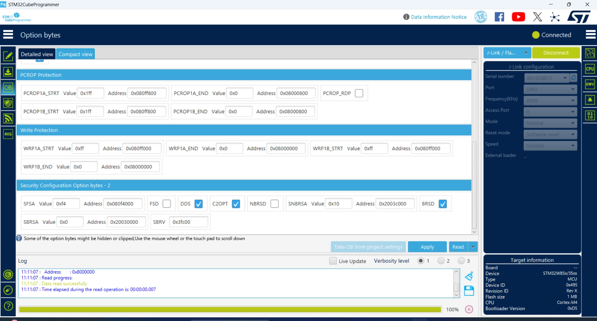

Could you try the same test on another board. Also, please send the values of all the option bytes for your Board.
Best Regards.
STTwo-32
Daniel_RH
Daniel_RHAuthor
Jan 24, 2025 4:21 PM UTC
I have 5 boards with the same customization, as I told you at the beginning, did not present any error but something made the BLE stopped working, as if the code was not executed.
Thinking that the error was due to deprogramming of the STACK and the FUS, we began to see the status of these looking if they were programmed.
When we tried to reprogram it, all this kind of failures started.
I have one card with FUS which is the one I am currently showing you and the others do not have FUS or STACK.

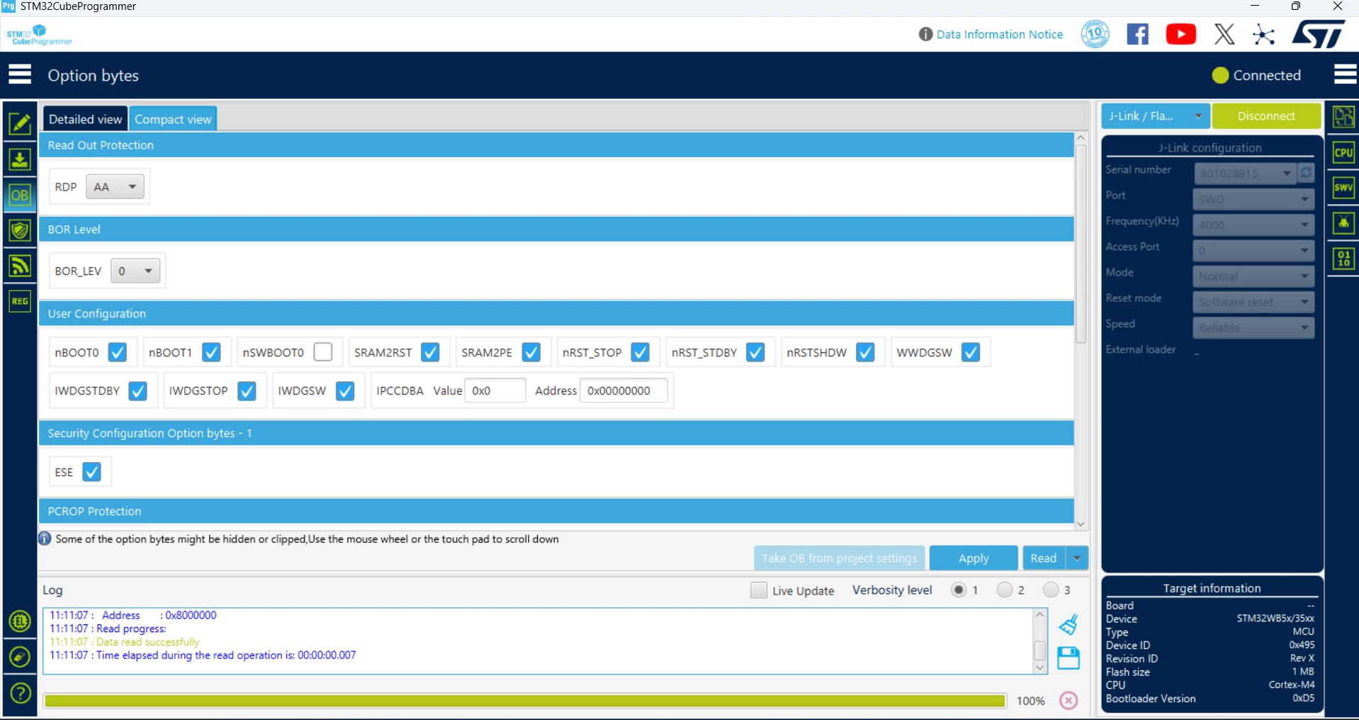

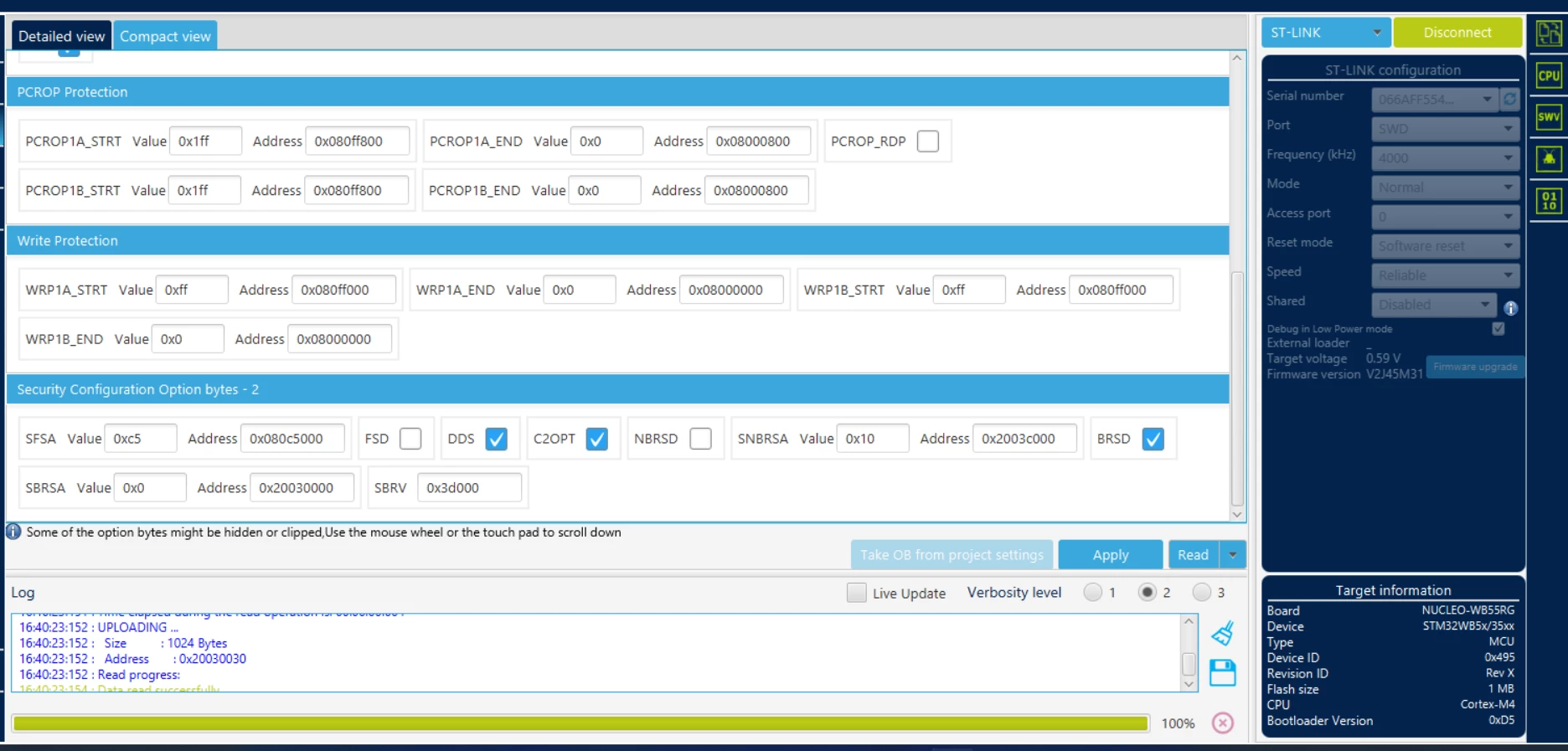

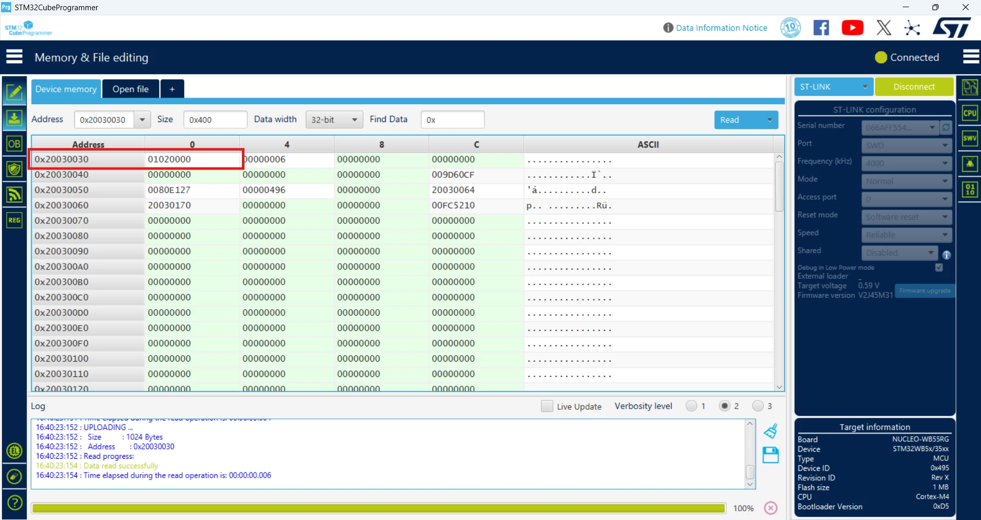

this is the pin configuration of another card
memory
Daniel_RH_2-1737735191947.pngDaniel_RH_3-1737735242894.pngDaniel_RH_4-1737735265365.pngDaniel_RH_5-1737735292856.png
