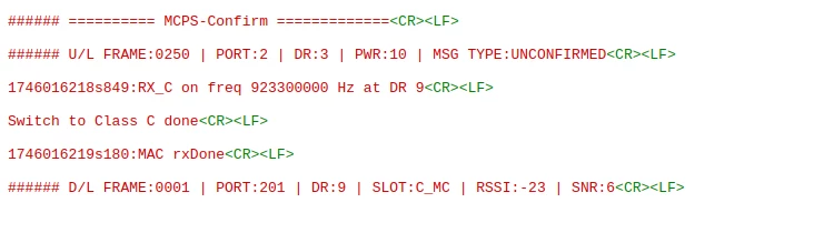

FUOTA fragments are not received after switching to Class C on the STM32WL55
  • May 2, 2025
  • 1 reply
  • 1255 views
I am currently working on implementing Firmware Update Over-The-Air (FUOTA) using the NUCLEO-WL55JC1 board with the STM32CubeWL SDK, version 1.3.0. The LoRaWAN server being used is AWS IoT Core for LoRaWAN.
Here is a summary of the issue I am facing:
  • I have successfully created a multicast group and initiated a FUOTA task from the AWS IoT Core.
  • The multicast session is established correctly, and the device performs the necessary handshaking steps without any errors.
  • At the scheduled time, the end device (NUCLEO-WL55JC1) switches to Class C as expected.
  • I observe that the device enters RX mode and shows RxDone status, indicating that it is listening for downlink data.
  • However, no FUOTA fragments are received by the device, and hence the update does not proceed.
  • On the AWS side, the fragments appear to be sent continuously.
The message shown in the image is the last log received on the end device after switching to Class C.
I have attached the FUOTA log from the end device.
Any insights or suggestions to resolve this issue would be greatly appreciated.
Thanks in advance for your support!
Best regards,
Abisha
